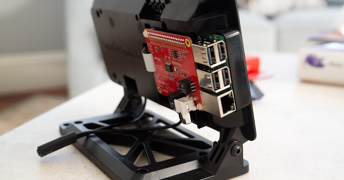

I’m using Volumio with a RPI 3b+ (run cooler than RPI4) with the audiophonics Digi+ pro hat
and QED performance coaxial cable with coaxial input of my amplifier (Advance Acoustic x-i60) and ethernet connection (avoid WIFI if you can)
Very good sound. It’ s a bit perfect connection, so no need of linear power supply

I’m not so expert, you have to look over both specs. Apparently they are the same (audiophonics is cheaper!)
I suggest you to use these HAT, so you can free a USB port. But if you have high quality files, maybe you should use USB port. These HAT can provide only CD quality 24bit/192Khz (that is good!)
