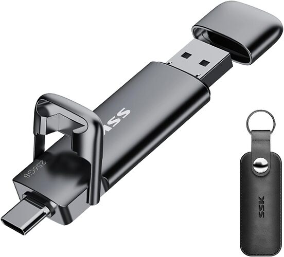

Using for development, builds, etc - actually, no matter what I throw at it and my personal favourite for all sorts, from pen-testing, throughout data storage, all way up to ESXi/Proxmox:
SKK SD301:
Speeds are similar if not the same as shown here:
Sizes from 500GB and up seem to prefer cold start on rPi4, meaning that reboot will not initialize the device.
