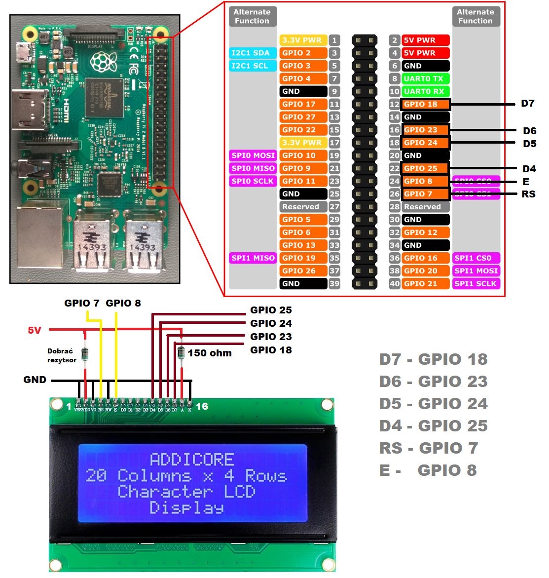

Hi. Basically your hardware connection depends on your plugin config. There is few plugins, but my favorite is pydpiper by dhrone or similar by Saiyato
Here you have a hardware connection sample
It should work after installation and proper configuration. Generally You can chose GPIO pins and many others by running a configuration script.
