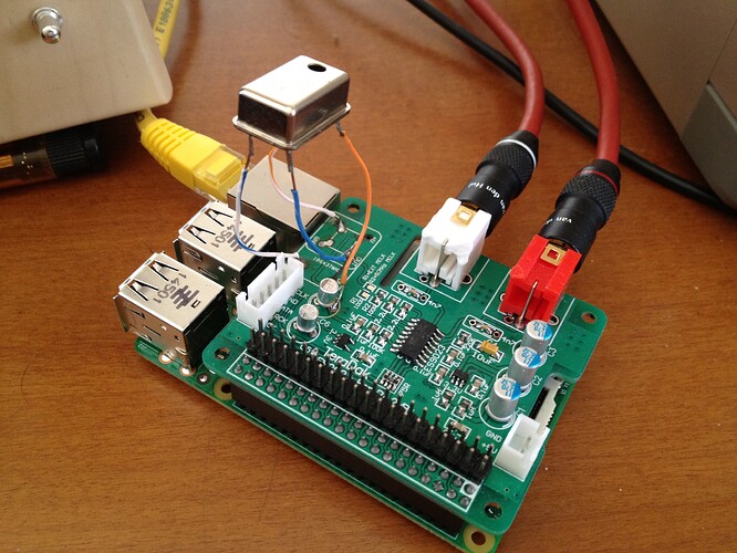

Hi to all,
reading here I bought this for 7/8 euro
It’s very similar to the basic es9023 on audiophonics
audiophonics.fr/en/diy-dac/a … -8396.html
I spend some month with it on rpi2 and Volumio
Well, I have to say it was a nice time to listening my music but just after (a very long actually) 60 days from order I receive the package with this
aliexpress.com/item/ONE-PIECE-PR … 58522.html
It was quite dramatic change :slight_smile:
Everything from definition to extension of reproduction improve a lot and imho, reach a quality I rarely had the privilege to listen
Probably the thing more stunning is the stereo positioning effect, 10/10 in my opinion
In the past I’ve spent some money on expensive gears, probably like many of us and objectively, I think it could be very difficult or impossible, to find something that can play your music better than this solution (rpi/es9023/tcxo) with less than 40/50 euro too!!
Consider also that I’m running everything from the usb pc port or an inexpensive 5v wall adapter, it make no difference for me, I can definitely live with it :sunglasses:
Don’t hesitate to put a i2s es9023 dac on your board but remember to check the possibility to have a 50Mhz high precision clock on it.
It will make a night and day difference and totally worth the money
bye
N1
So you bought the board and the crystal right? Please tell me the way to install it! Soldering or plain simple inserting such as an opamp.
Sent from my iPhone using Tapatalk
you’ll have to unsolder the previous one :wink:
And put the TCXO according to the footprint on the PCB…
like here :
A good clock is very very important
Thanks. Do I need anything besides unsoldering and soldering? I can have a friend with the proper tools do the soldering job for me.
Nothing more is needed (be sure to put the clock the right way).

NickOne, I am interested in doing the mod to my DAC but I notice from your image that you did not solder the crystal directly to the board but rather used fly leads, is there a reason for that? I also notice that the wires don’t go to the four corners, although I can’t see that well from the image exactly where you did solder them! Could you give further clarity please?
My 2c is NickOne wanted to quickly test out the crystal which he bought. Am pretty sure that he has already soldered it nicely to the board.
