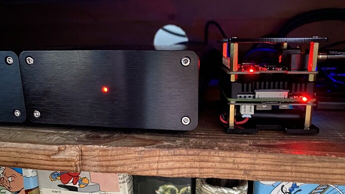

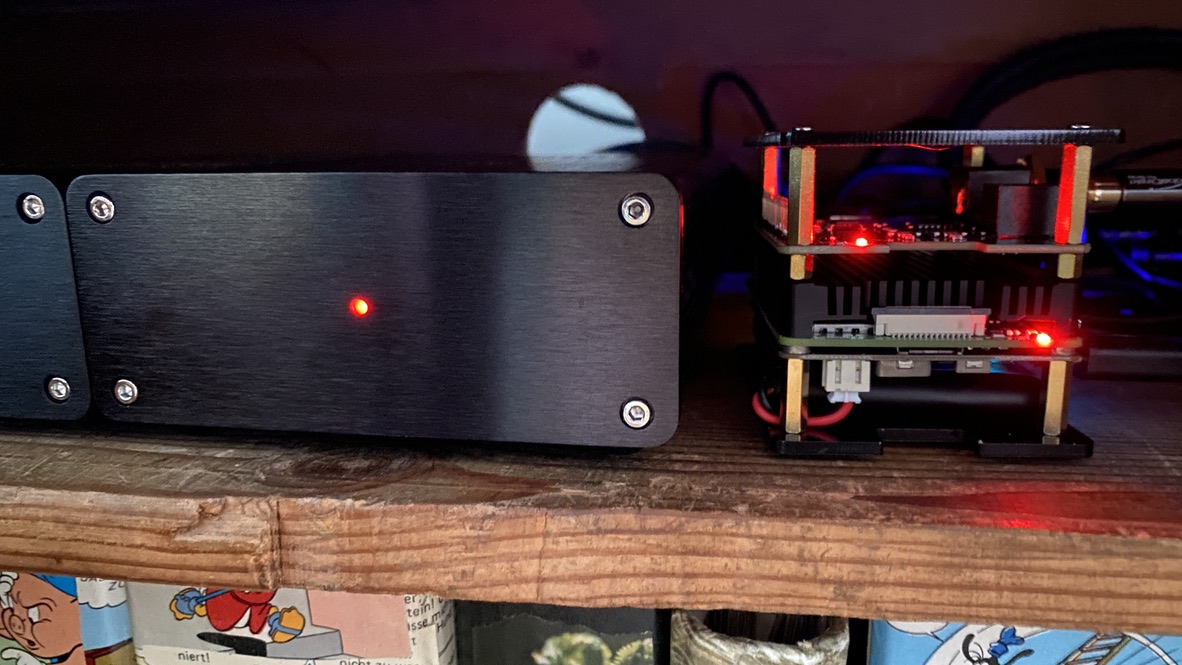

              Hi there,
it took a bit longer to develop the project to its actual state. At first i didn´t know that usb charging needs some resistors called cc-resistors. After all the new PSU works great. For me a linear PSU is mandatory. Most Harshness in sound is gone and the soundstage is more defined. Bootdrive and music library each got there own ssd which makes working speed and soundquality even better. I recommend only using usb powered drives as there is another noise source when using a harddrive with external psu.
I have major complaints about the usb output as in some cases there was dc output so my RME Dac 2 FS shut down the input. Some weaker Hardware could get damaged by such signal. This and the point that i want to use the usb input for the laptop i bought a S/PDIF hat called Innomaker Digi One. This hat works fine on volumio with the Allo Digione driver. It´s not the greatest of all but works very well in combination with good power source. After hours of searching the internet for a simple “safe-shutdown” solution i gave up and bought the pisugar 3 plus UPS which works great, has a web interface and a smartphone app to configure it to your needs. In my eyes a well made product.
Temperatures are 60°C max in this closed enviroment.
