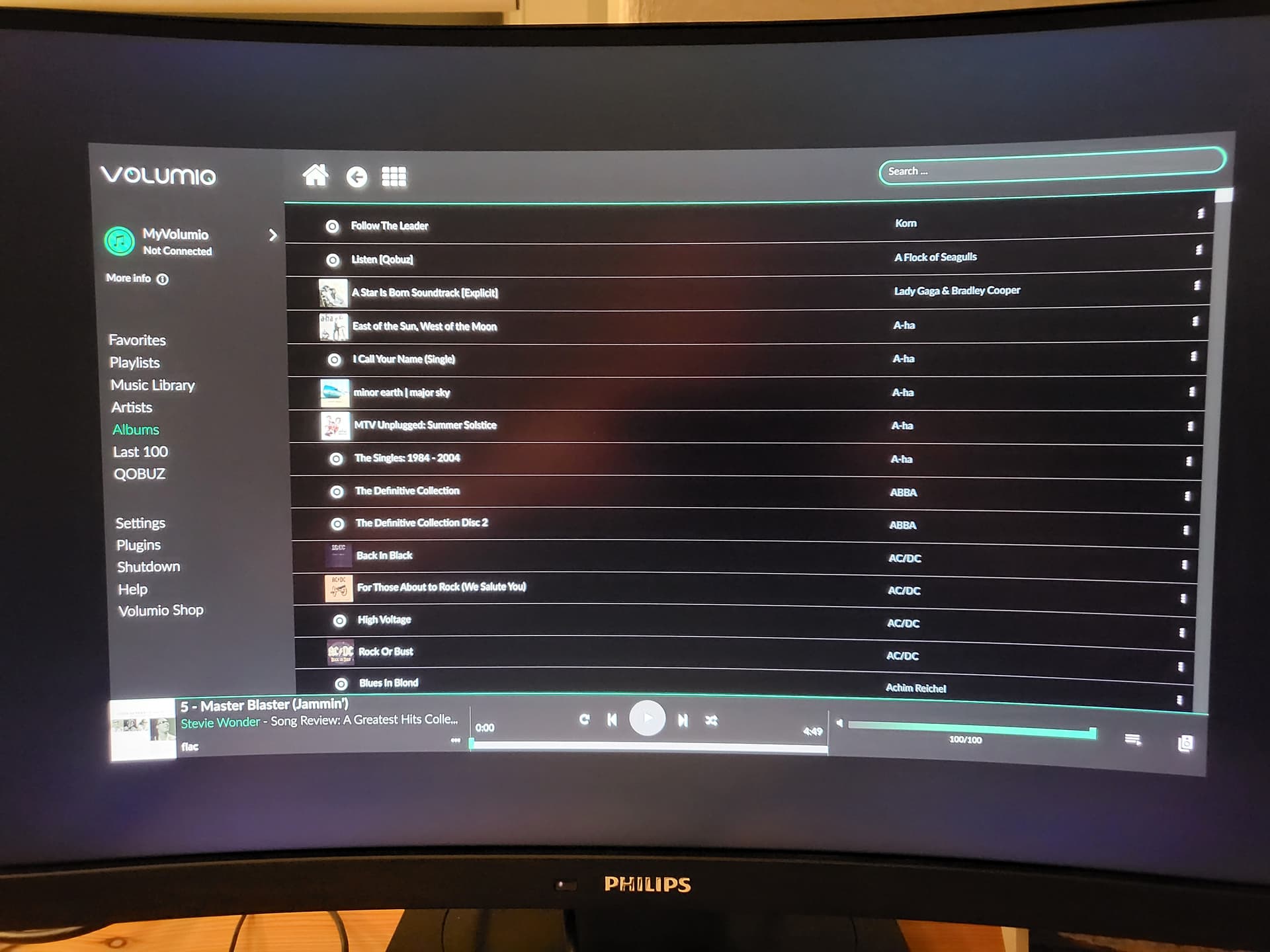

Anyway, I noticed that with the recent update of Volumio Rivo from 22nd July 2024 (I don’t have the version number by hand) it has been solved! See attached screenshot, with a playlist, not an album, but you can see that the playbar at the top and the left horizontal menu is there now, as it is characteristic for the contemporary UI.
Thanks!
