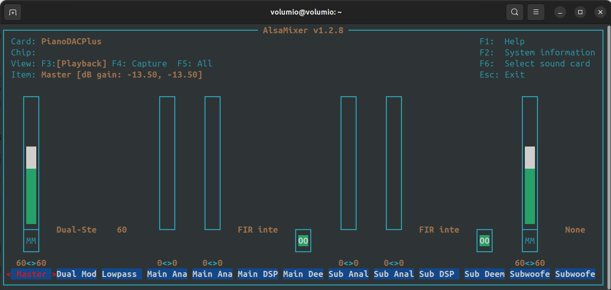

I have an Allo Piano 2.1 (with kali reclocker)
With Volumio 4, i don t really know/understand the various setup in Alsamixer.
I used the dac in dual-stereo (2 different amp connected to it) and want same sounds for each stereo set.
If you have a similar config (dual stereo) and are satisfied with it, would you mind posting a picture of your alsamixer configuration?
Thanks in advance
On my side, to avoid what i think is clipping (very crisp sound, fatiguing…something i don’t have when playing my amp from a phone+dac and analog out or a cheap Bluetooth receiver with analog out), this is the config i am experimenting:
Master Volume: 60 (db -13.5)
Dual Mode Stereo
Lowpass 60 (but i don’t have subwoofer, and using dual stereo mode)
Main Analog: 0 (dB gain -6 -6)
Main Analog PlayBack Boost: 0 (dB gain 0 0)
Sub Analog: 0 (dB gain -6 -6)
Sub Analog PlayBack Boost: 0 (dB gain 0 0)
Subwoofer: 60 (dB gain -13.5 -13.5)
Additionally, in Volumio, i put the Max Volume to 80 (instead of 100) to be sure there is no clipping / fatiguing noise.
