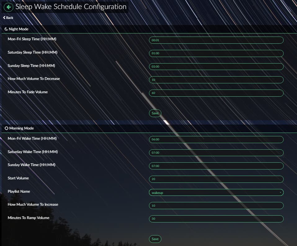

I also realized that a more advanced alarm and sleep system was missing. Yesterday, I submitted the Sleep Wake Schedule Plugin, which is now available in the beta plugin store as of today. To use it, you’ll need to enable beta plugins in developer mode. Once you do that, it will appear under System Tools.
If you want to use it with the radio, you’ll need to add the radio to a playlist and select that playlist in the plugin’s settings.

Is it possible to prevent to turn on, on saturday and sunday?
Like leave the options in blank?
