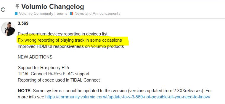

Tested two albums with the first track shorter than the second (after restarting the system): I confirm that version 3.569 fixed the problem!

Just tested 3.569.
Exact same problem as 3.512 for me on RPi 4B.
I’ll check and re-apply the fix to statemachine.js and see what happens.
Initial testing of 3.601 suggests this problem is fixed.
@M1ck … are you in a position to upgrade and retest on your system?
I have not tried 3.601 yet.
But… the issue of volumio displaying one track ahead if the fisrt track was longer than the second was fixed in the last release (3.569)
