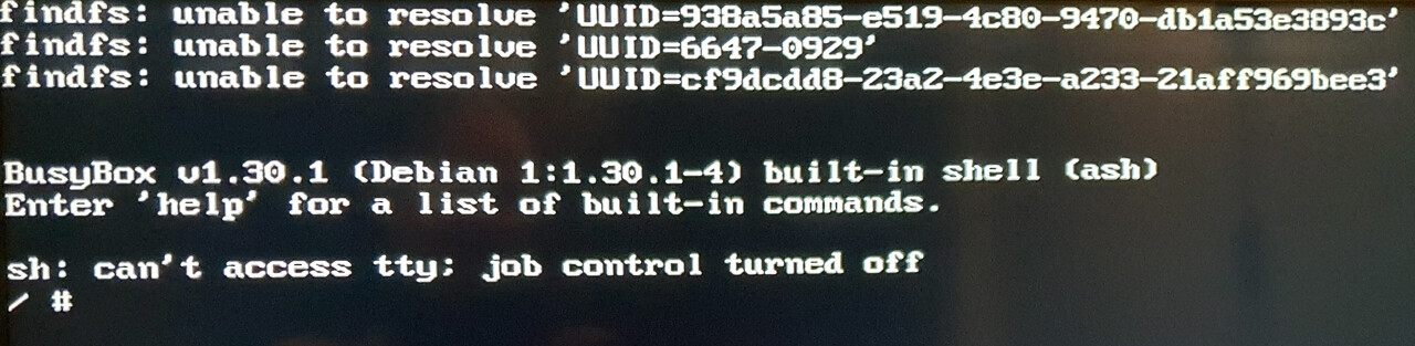

I have Intel NUC NUC8I5BEH with nvme drive inside (Windows 10, Kodi and jriver) and 4TB NTFS formated SSD drive (with my music in FLAC files). SSD drive with my music have label iSSD and this solved problem that now Volumio can see music on this drive.
First I downloaded Volumio-3.512-2023-06-25-x86_amd64. Then used rufus to create bootable USB drive (16GB)
Before I connected this bootable USB drive with Volumio on it I disabled SATA and m2 port in my NUC bios. Just in case as I didn’t wanted to get in trouble when installing Volumio.
After this was done I started my Intel NUC from this USB drive with Volumio image on it. No problem with this.
I could use Volumio and everything was fine.
Then I wanted to install it on my external USB C Orico enclosure with Samsung 256GB nvme drive.
Everything was OK until restart. Then I got error.
So… I was thinking that maybe Volumiobuster will make it. Volumiobuster-3.538-2023-08-07-x86_amd64
Unfortunately I did everything like previous try and got the same error. Please see the picture.

The nvme driver module is in the initramfs, so there must be another module missing causing the drive not being recognized during the init phase and cannot be booted from successfully.
You are the first person to encounter this issue, sorry.
Could you tell me which USB C 256GB nvme drive you have?

Finally closed this Orico usb to nvme adapter issue, caused by missing UAS (usb attached sata) support in our initramfs.
There was no relation with nvme at all, just a missing usb storage module in initramfs.
Thanks @JMZ for reporting this issue, would not have found it otherwise.
To be released with the next version of Volumio 3, with current and upcoming 6.1 kernel.
