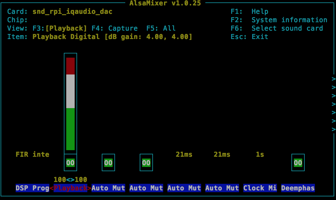

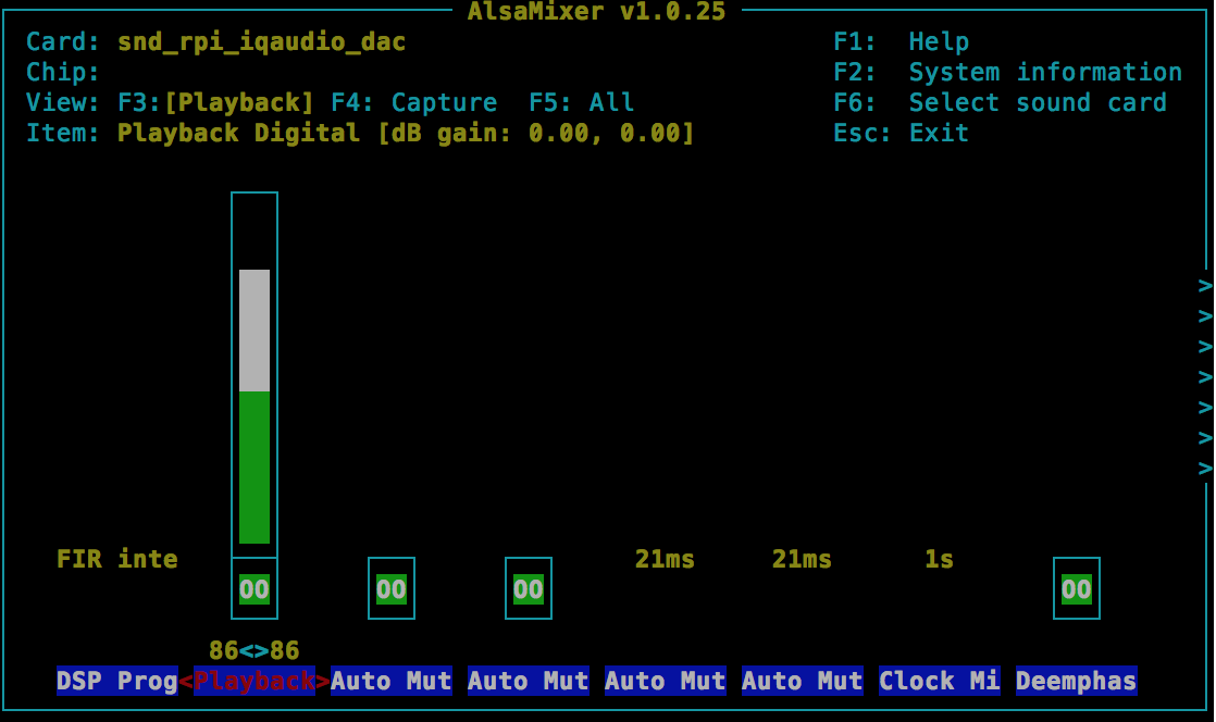

Alsa volume range is directly linked to the card’s linux driver and what the driver exposes. Each card’s driver will do things differently and each DAC will have a different “internal” volume range.
For the IQaudIO.com Pi-DAC the PCM5122 DAC has a vast range but I have limited the usable range within the linux driver to -103.5db to +4db (0 to 100 in alsamixer).
0db corresponds to 2vRMS output (top end of green in Alsamixer). Going into the red is okay and may be needed for especially quietly recorded tracks. I considered giving even greater ability to push this further but felt compelled to limit the output for audio quality.
Other card’s drivers may be completely different, and IIRC the Wolfson chip used is a 1vRMS output or thereabouts.
