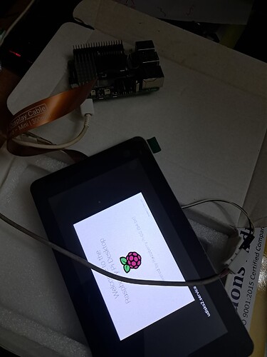

The screen is blank no activity, no login prompt. the display works perfectly with Raspberry Pi OS in the same setup .
only this line
Please add
dtoverlay=vc4-kms-dsi-7inch
to “/boot/userconfig.txt”.
Added saved and done the reboot but still no activity in screen
Is the display connected to the Pi’s DSI1 port?
Does the error message disappear without the “vc4-kms-dsi-7inch” overlay?
