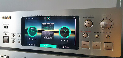

Ok. Your setup looks very nice BTW

Yes,
Nice looking setup
