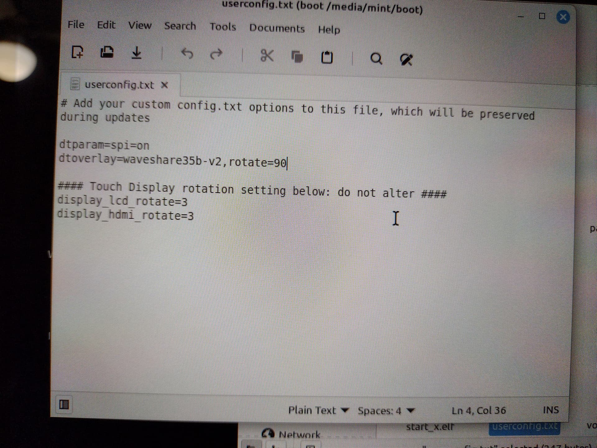

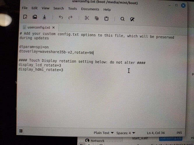

Thanks for the quick reply. That is the procedure I used. I ran the script you suggested. The Touch Display plugin does not report any error but the screen is still blank. Same error on both RPIs. Here is the log again:

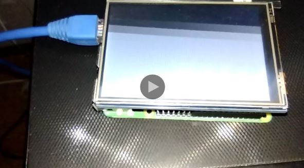

Hi i have followed your intstruction and my waveshare 3.5 inch LCD (B) rev 2 LCD is still not working and display gui .It just for step 4 its says install xserver-xorg-input-evdev package and i searched on google and it says to do sudo apt-get update and also sudo apt install xserver-xorg-input-evdev,and sudo reboot.
This is what i wrote in userconfig.txt
This is photo of what my screen do it shows a white thing and dispear
lcd screen show white thing
help would be appracaited
Hey @Mat2,
The fact that your screen lights up briefly is actually promising - it suggests the SPI interface is active. What we don’t know yet is whether the kernel has created a framebuffer device (/dev/fb1) for the Waveshare panel and whether the relevant drivers have loaded.
Please note: I don’t have this specific screen at my disposal and I’m not looking to buy one, so you will need to carry the burden of investigation yourself, unless other community members who do own this panel can step in and provide exact details for the Volumio version you installed (which we still don’t know - the log will capture this).
Here’s what to do next:
1. Disable the Touch Display plugin
In Volumio UI go to Plugins → Installed Plugins and switch off the Touch Display plugin. For now we only want to see whether the kernel has a working console on the screen, not the UI.
2. Send a Volumio log link
  • Open a browser and go to:
    http://<your_volumio_ip>/dev
  • Scroll to the section Send logs of bug report.
  • Enter a short note (for example “Waveshare 3.5B SPI not showing UI”).
  • Click Send.
  • Copy the link it gives you (from logs.volumio.org/...) and paste it back here.
3. Collect framebuffer and module information via SSH
On the same DEV page you can enable SSH. Then connect to your Volumio (user: volumio, password: volumio).
Once logged in, copy-paste this block and return all of its output:
echo "=== Volumio version and kernel ==="; cat /etc/volumio_version 2>/dev/null; uname -a
echo
echo "=== Framebuffers ==="; cat /proc/fb; ls -l /dev/fb* 2>/dev/null
echo
echo "=== Modules of interest ==="; lsmod | egrep -i 'spi|ili9|fbtft|fbcon|vc4|drm|ads7846' || true
echo
echo "=== Recent kernel lines (spi/display) ==="; dmesg | grep -i -E 'spi|ili9|waveshare|fbtft|ads7846|fbcon' | tail -n 120
With the log link and this small set of outputs we will know:
  • Which Volumio version you are running.
  • Whether the kernel created a framebuffer (fb1) for the LCD.
  • Which modules are loaded (spi_bcm2835, ili9486, ads7846, etc).
  • Any errors when the overlay tried to initialize the panel.
Once that’s clear, we’ll know whether the display is alive at kernel level. If it is, we can then look at enabling the UI later.
