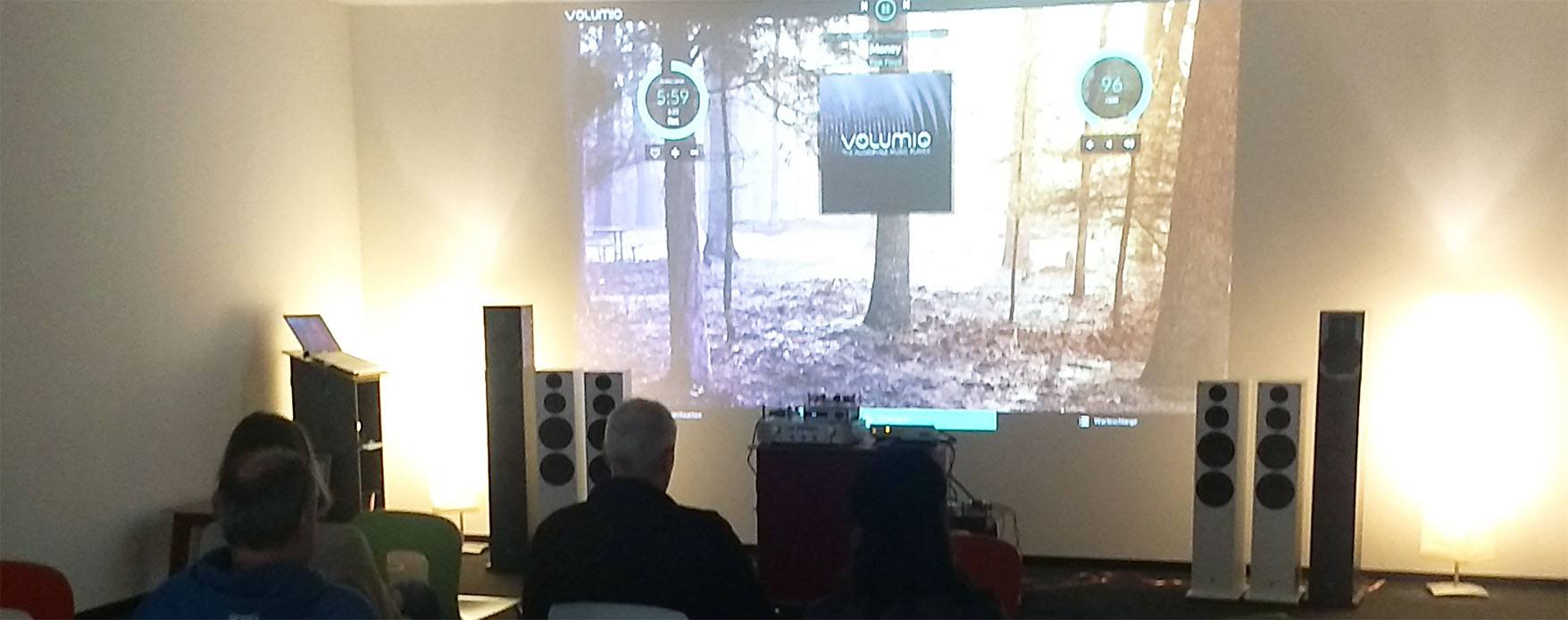

part I of Soundcheck, yesterday.
First i explained the six guests the advantages of volumio.
in the ‘warm up’ round we had a setup with three amp’s to compare.
(allo said, the announced elac amp would not be great) :wink:
so we compared the Marantz PM6003 (used in the souncheck past), the Elac EA101EQ-G and the allo volt + D amp.
We used 3 ELAC FS 78 speaker pairs. The volumio primo provides the signal with a switch and a remote control to the three amps.
We realized very fast, that the elac did not sound as well, as the other. (in a blind check, of course)
The Marantz was more warm. the allo a bit more detailed. The group was 50/50 to decide which one would be best.
I decided to take the allo in the next round, the DAC competition, because we already heard most of the DACs with the marantz…

… and our winner in best sound quality is : volumio primo !
very closed followed by the allo Katana THD board and DACBerry Pro.
Some of us also said that they would prefer the Katana Board in a certain genre of music, and in others the volumio player…
All of the tested boards were very good. no board disappointed us.
Katana v1.2 with THD stage and Isolator with Dual LPS Thel NT-25HQ-09
Volumio ‘Primo’ (on Tinkerboard S) with shipped psu
DACBerry Pro with one line of NT-25HQ-09 LPS
X400 DAC extension module, 19V IQaudio PSU
DACBerry ONE+ with one line of NT-25HQ-09 LPS
Mamboberry HD DAC+(crystek) & kali with mambopower LPS
Khadas gneric tone board on RPI 3b+ and ifi ipower
IQaudio DAC PRO with 5V allo dual PSU
volumio 2.555 was used in all setups. same playlist as before.
Piano 2.1 with Kali reclocker did not work in dual mono.
I was happy to see the new I2S driver for the DACBerry boards in this volumio version.
The apple pi was gone, because orchadaudio asked for his board to get it back.
Many thanks to allo, michelangelo, collybia and OSA electronics for the great support of the soundcheck.
We used the allo volt+D (Dual) amp, with the 19V from allo dual PSU.
Loudspeaker were the compact ELAC BS 244.3 (they are great)
The pleasure is always the come together and speak about what we are hearing.
When people are talking about " i was falling in the music scene", or “the sounds were frayed” …
thanks for coming!

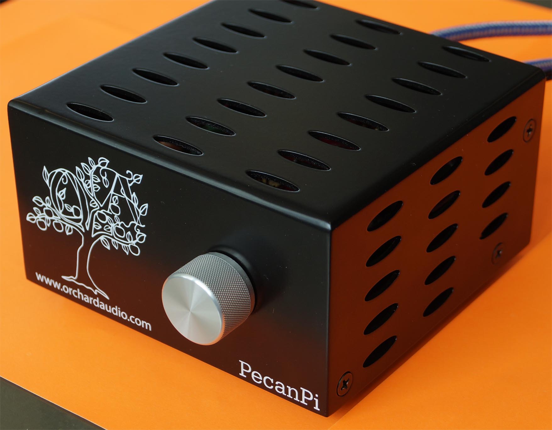

Just got the PecanPI streamer - a new, complete player setup from orchardaudio.com! (have attention enthusiasts)
