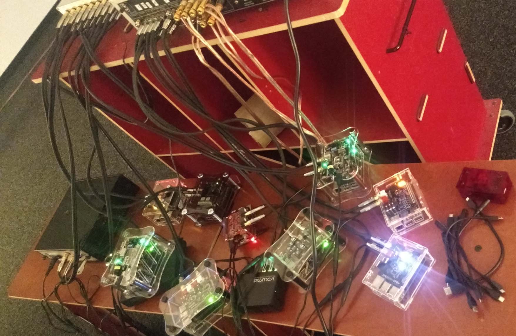

Hi friends,

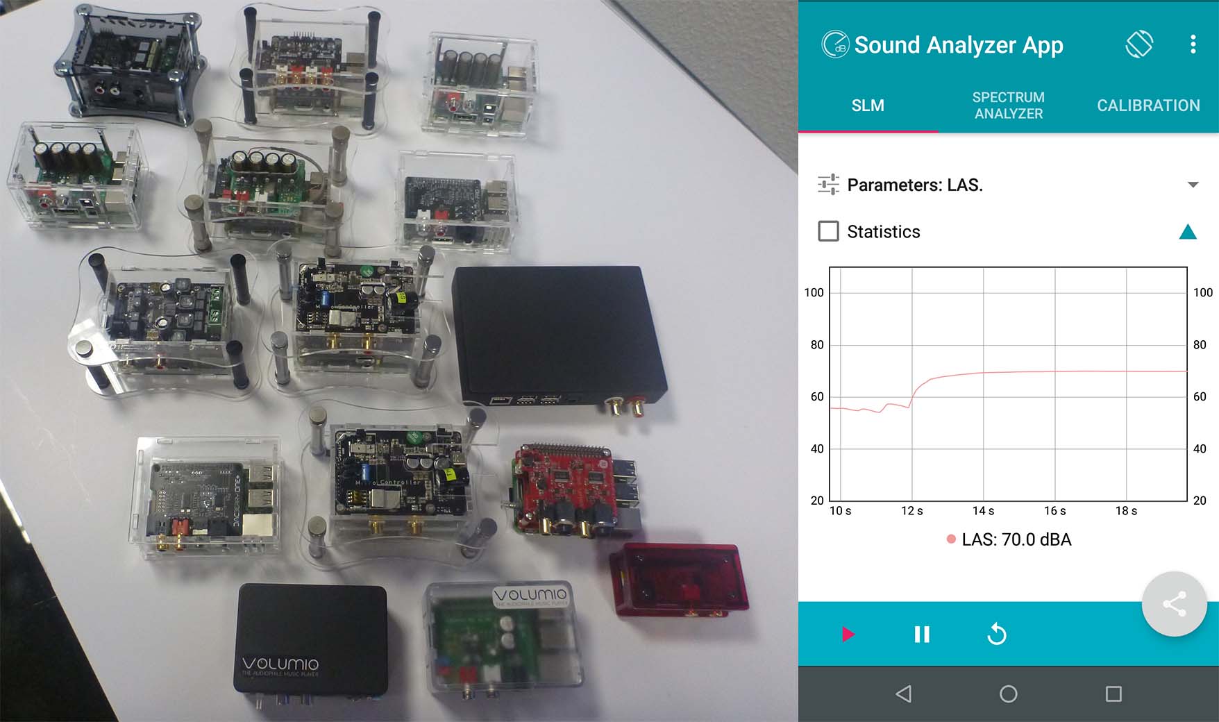

you may interrested in what we find out yesterday. We had a big, long session and Ronald bringed his Curryman DAC (a ES9023DAC). Before competition,i was preparing all setups to the same soundlevel ( The biggest differenece is between Terraberry2 and DacBerry pro) . I had to put the Terraberry to 100% and the Dacberry Pro to 60% volume!)
All setups powered with the same, the allo 5V3A psu. Katana, Terraberry and Piano where powered by two psu’s, applePi with three psu:
