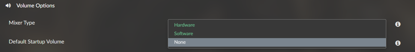

Volume Options I noticed in the Volume options, if you set the Volume to “None” (which I prefer because I use the Preciso to control volume) the streamer volume decreases to 41 which is strange. I know this because when I set the volume back to “Hardware,” 41 pops up on the on-screen volume wheel. Setting the startup volume to 100 does not fix it either.

Volume options:
In my case the Rivo + Primo Plus as DAC. (DAC part is pretty similar to the one of the Preciso).
There is some weird behavior going on.
Rivo is normally always on “none”. After a reboot, the Volume control shows a slider. When trying to move it, it goes away.
If I try to switch to Software control, Volumio crashes (log).
After the crash we have a HW mixer available???
Setting it to “None”, Volume is 100%.

please set the volume to HW and keep it at 100%, you won’t have any difference compared to setting it as None
@Darmur Yes, that is what i did.
@Wheaten now I see your solution, so I did just that and all is fine.
Thanks to both.
