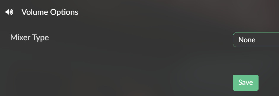

Rivo with 4.185, why do I get the option for Hardware Volume Control on Rivo, when Rivo itself does not offer a hardware volume control? In Volumio 3, I only used to get the options of None or Software. Is there a difference between setting the option to None or Hardware on the Rivo?

No, this is just a configuration glitch that we will be fixing. Thanks for the report!

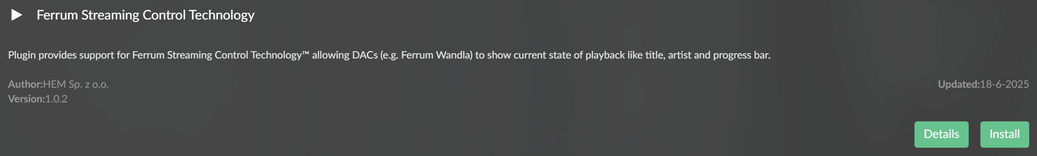

If you are using Rivo+ (Roon) with Ferrum Wandla make sure to change the settings to:
under “General Playback Options”.
After that the FSCT-Plugin shows up again:
The current SW update (4.185) breaks the settings so you will have to do the above.
