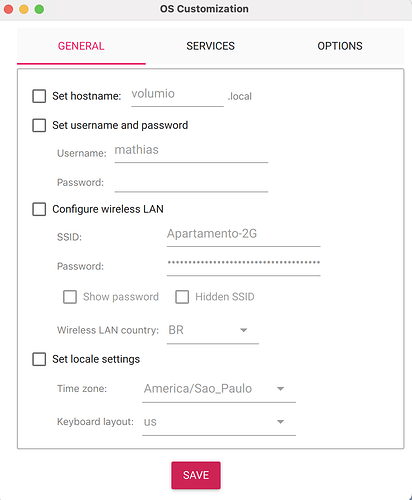

Should I fill in any additional settings on the customize option the RPi Image app (see attached screenshot)?

  • No you don’t, have you tried with a different SD?

OS customization from Raspberry Pi imager must not be applied when writing Volumio on the SD-card, it is meant to be used with RaspiOS only

I wrote the image on the SD card with any OS customization and the app is still not recognizing the Volumio device…

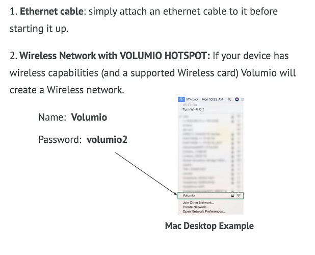

Interestingly the Volumio device to not create a Volumio Wireless network (see screenshot).
