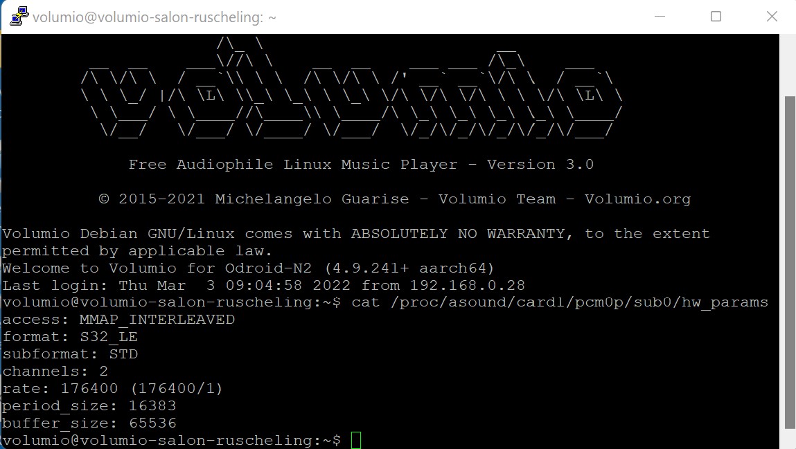

Could you do a
cat /proc/asound/card5/pcm0p/sub0/hw_params
to verify format and rate while playing DoP128 and, to compare, playing DoP256?

oh that was my mistake, I meant
ls -l /proc/asound

replace card5 by card1
Now we’re talking
Some strange things happening here. I have streamed music at various DoP rates and I am getting strange bitrates with the command (screenshots further down):
DoP64 → bitrate 176k → ok
DoP128 → bitrate 352.8k → ok
DoP256 → bitrate 352.8k → not ok
DoP512 → bitrate 384k → not ok
