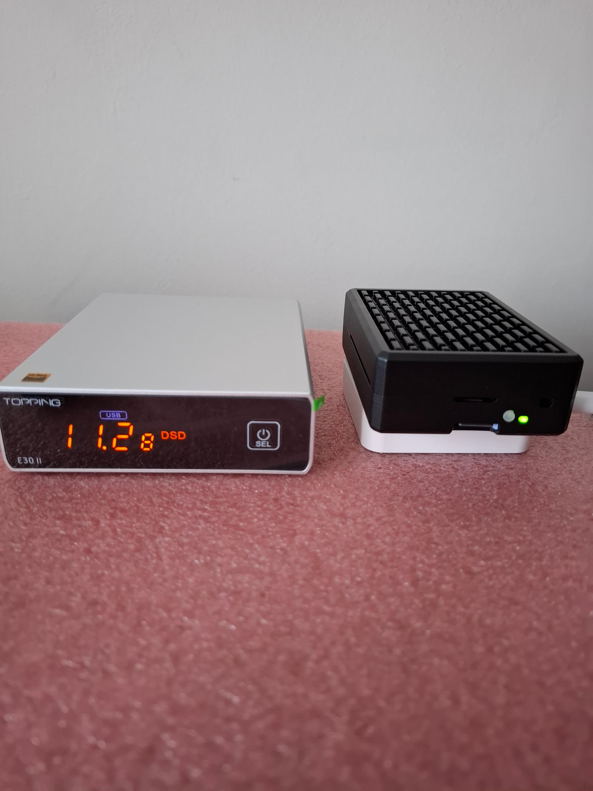

Hello everyone.
Today, the new topping E30 ll dac I bought was delivered. I immediately integrated it into my system consisting of Raspberry pi5 and Volumio.
Despite making all the settings, I could not get DSD sound. It was constantly trying to give sound via PCM. I tried to find a solution by reading the posts here and in other forms, but it did not work.
Then I reset the system to factory settings and tried again and the result. Real DSD :+1:
