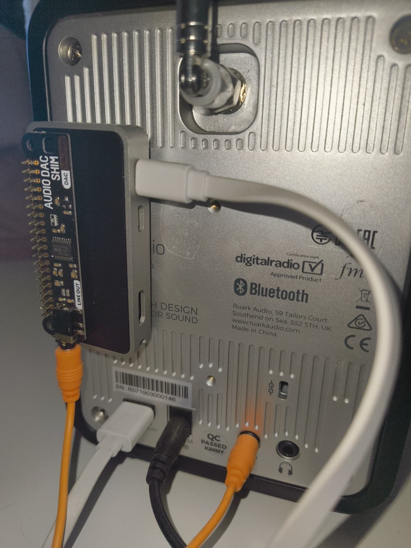

RPi0-2 W is officially supported and working fine for a headless system (not powerful enough for connecting it to a display)
My bedside system: Ruark radio with RPi0 2W with Volumio v4, working fine!
