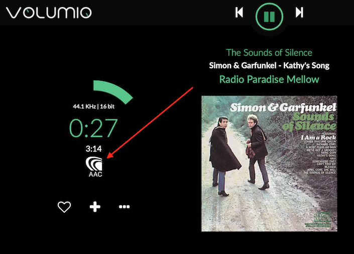

Restart your Pi. Otherwise open a private/incognito browser window. It should look like this:
You can also see it in the logs by running
sudo journalctl -f
there should be the url (with *.m4a extension), something like
ControllerMpd::sendMpdCommand add "https://audio-3.radioparadise.com/blocks/chan/1/3/168308-168311.m4a?src=alexa"

I see the AAC icon.
It is playing audio-3.radioparadise.com/block … ?src=alexa
that is to say, it is fine.
