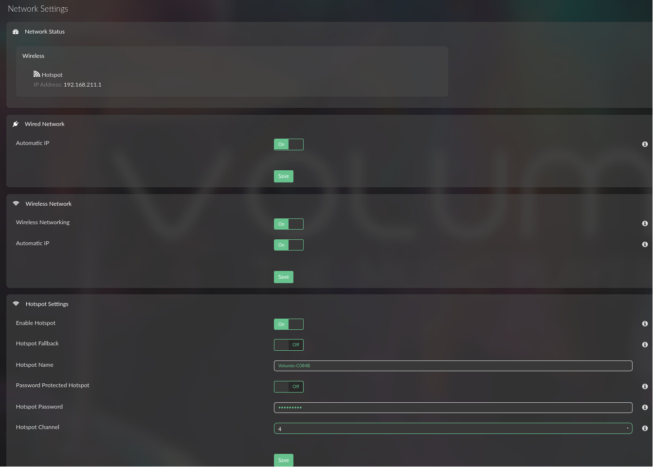

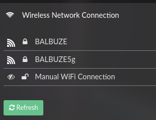

Higole pro
After a new USB flash v0.066
  • first wizard with empty network settings
  • still no WIFI scan, so ethernet cable required to configure network.
  • after disabling the hotspot, the wifi scan is ok
