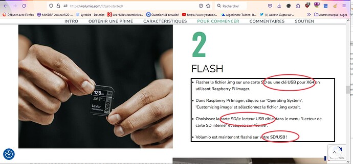

Please could you update these pages accordingly, because USB appears to be a working solution
the same in english … :wink:
Anyway, as a beginner in this area, thanks to this, I discovered and learnt a lot of things
Good luck for the dev …
Bye
where (what page) did you get the info that USB is working on Raspbery Pi?
Look in the text surrounded
Not actually: It states to boot from USB for x64, not for the rPi. But as @Darmur stated, WIP.
OK, understood,
Nevertheless, for beginners like me, perhaps a wording like this would be clearer:
Flash .img file onto SD card for Rpi or USB thumb drive for X64 using Raspberry Pi Imager.
on step #3 is clearly mentioned, USB if using a PC
