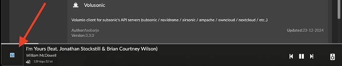

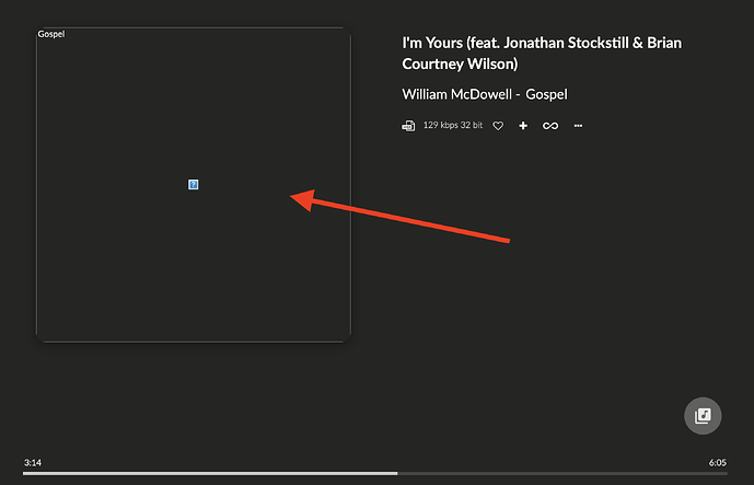

hi @foobarjo, I just tried using my Gonic instance with your Volusonic plugin. It works great but all cover images seems to be broken. Is there a way to load a default icon/image if the album cover art is not available?
