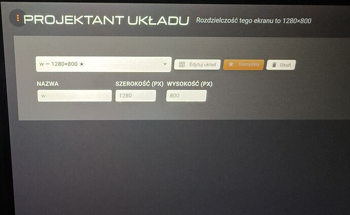

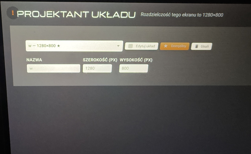

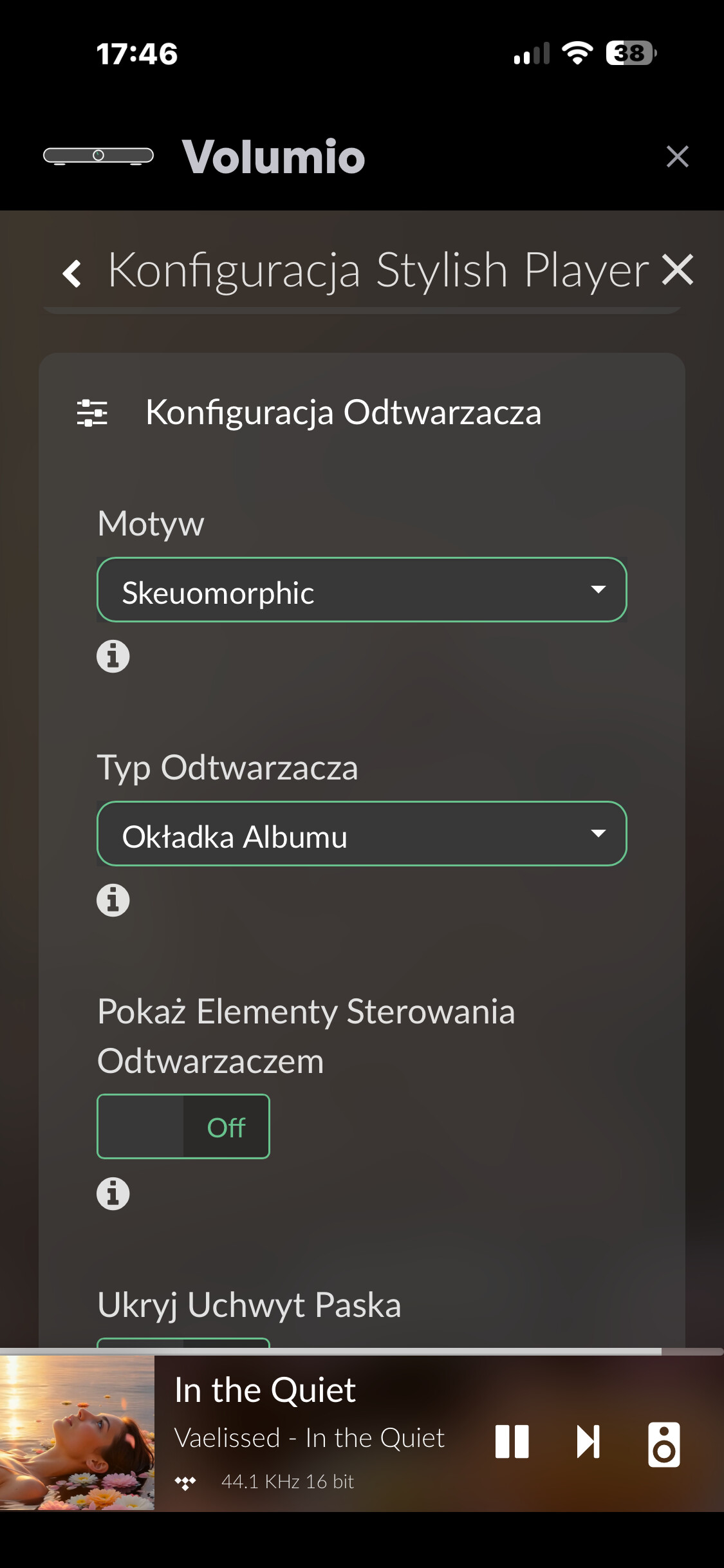

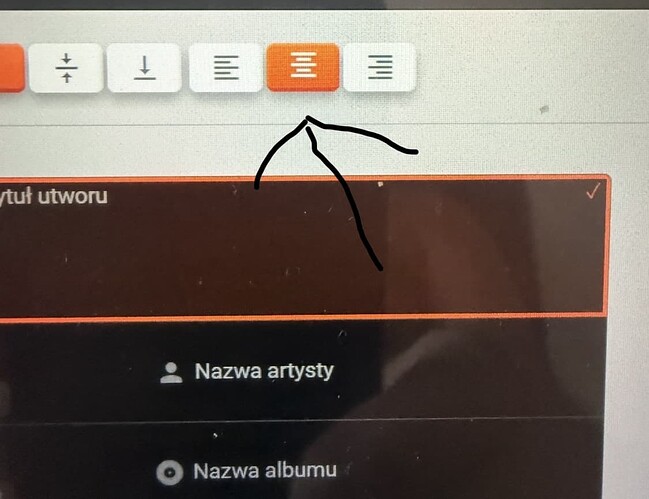

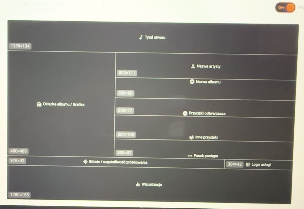

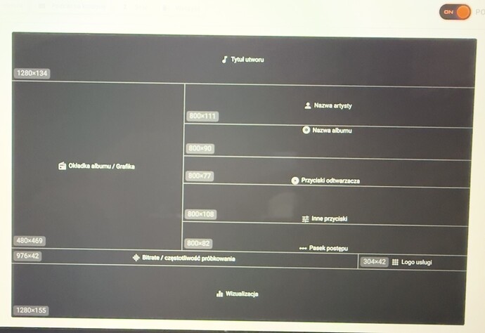

Can you do Settings → Export Settings please? Not layout export. I need complete settings, including the custom font size and theme you have applied. Thanks.
I only changed these two settings, the rest remains unchanged
I don’t see any problem? Nothing is getting cut.
I described it earlier, if you can’t see it, it’s a pity :disappointed_relieved: there is a problem with this song skipping in the middle setting Regards
The problem is probably in your Raspberry Pi (no hardware acceleration and dropping frames).
Quote - The problem is likely with your Raspberry Pi (no hardware acceleration and frame drops).
I have a Raspberry Pi 5 16GB and I think it’s happening to all Raspberry Pi users, not just me. Okay, so be it. Overall, the plugin is great!

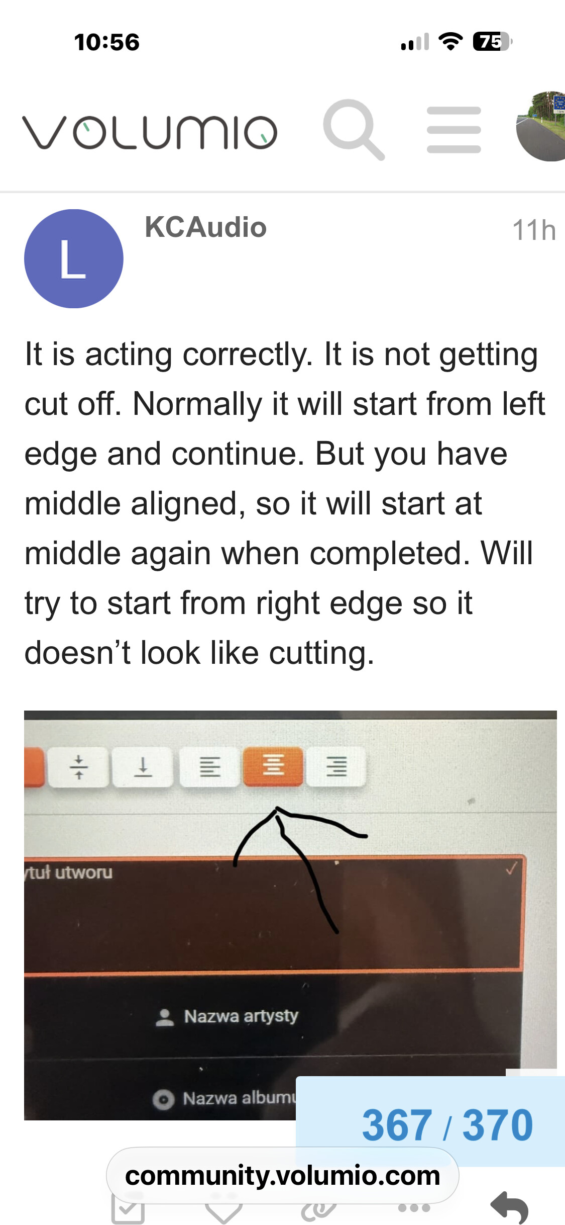

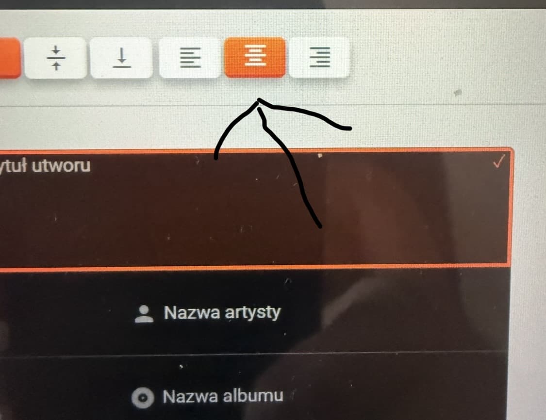

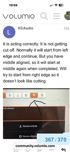

Are we misunderstanding each other? The text on your photo file doesn’t flow smoothly either - it cuts off halfway through.
It is acting correctly. It is not getting cut off. Normally it will start from left edge and continue. But you have middle aligned, so it will start at middle again when completed. Will try to start from right edge so it doesn’t look like cutting.

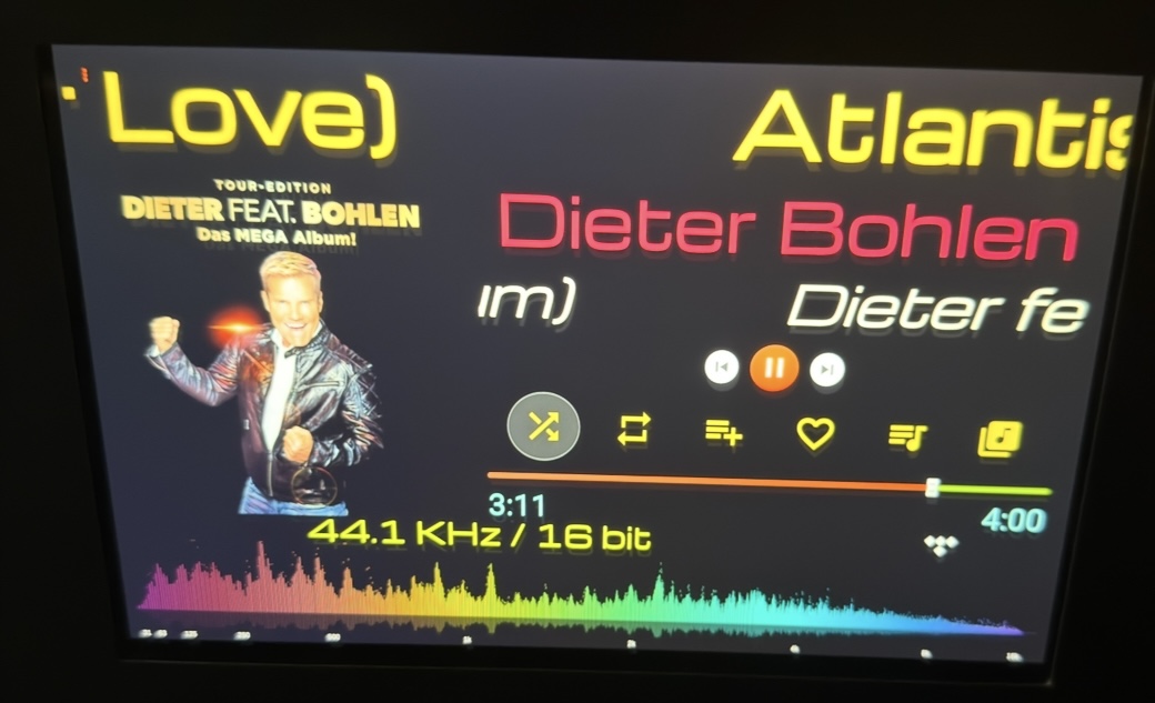

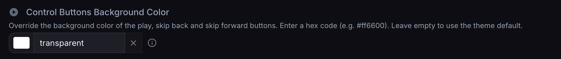

Added transparent option for Control Buttons Background Color

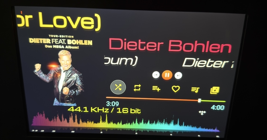

Much respect! Thank you :smiling_face: for everything. It looks much better now. I don’t know how you do it, but could you change the gap between the beginning of the song and the end so that it doesn’t completely disappear, but appears smoothly after the end of the text (like now, but with a space of, say, 8 letters)?
If it’s not possible, it’s not feasible, that’s okay, really great respect :saluting_face:

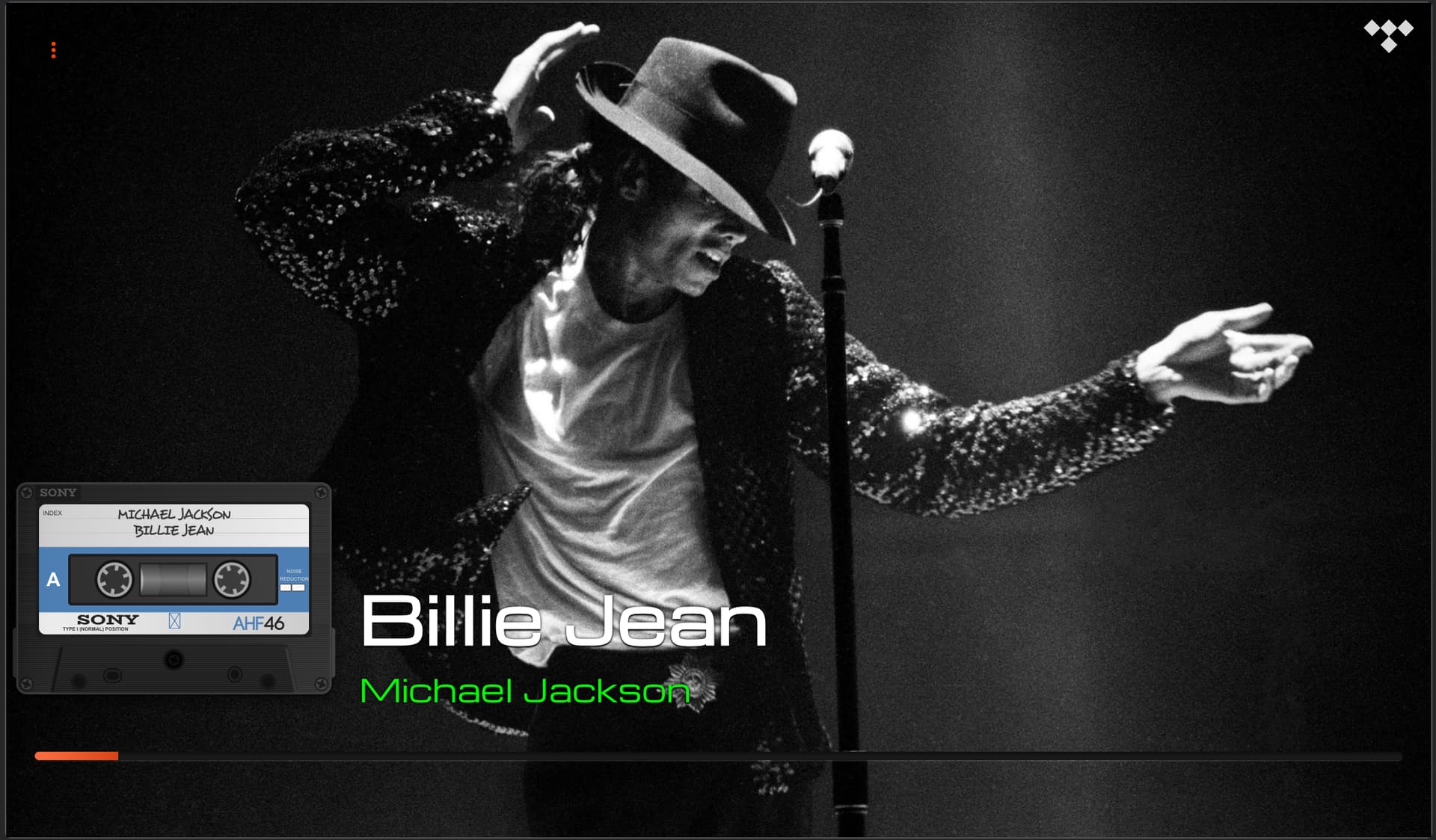

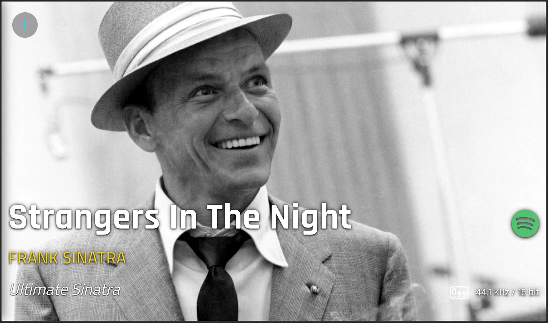

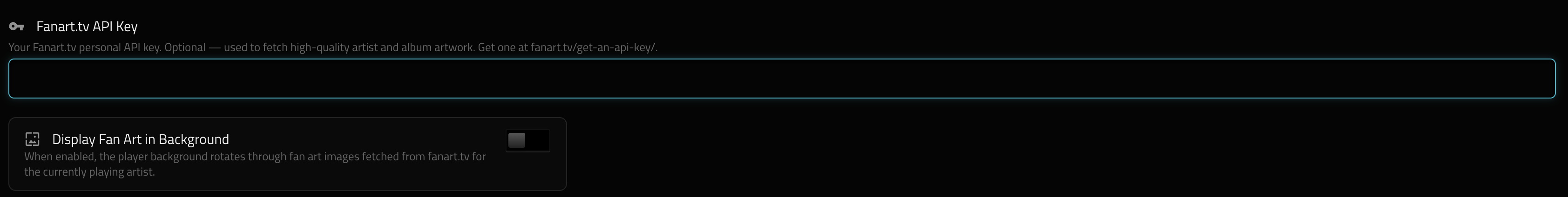

Thanks to the brilliant idea of @Gelo5 regarding FantArt , we now have integration with FanArt API into Stylish plugin.
You need not download FanArt, but the API will take care of it. You need to register for your own API key here https://fanart.tv/get-an-api-key/ and then enter below
Best works with custom layout like this (no album art or viz should be there)
Sample
Also integrated into Peppy Meter (only some resolutions, but Stylish can automatically resize, so use the one that works with your screen aspect ratio)
Download FanArtCD zip and upload to Peppy Meter section in Stylish Player.
Sample
Note: The CD will now have real album CD cover rotating (fixed in 1.3.1)
Adjust font size, color, layout accordingly. WARNING This version has changes to custom layout so it will mess with your existing layout forcing you to resize some stuff as needed.

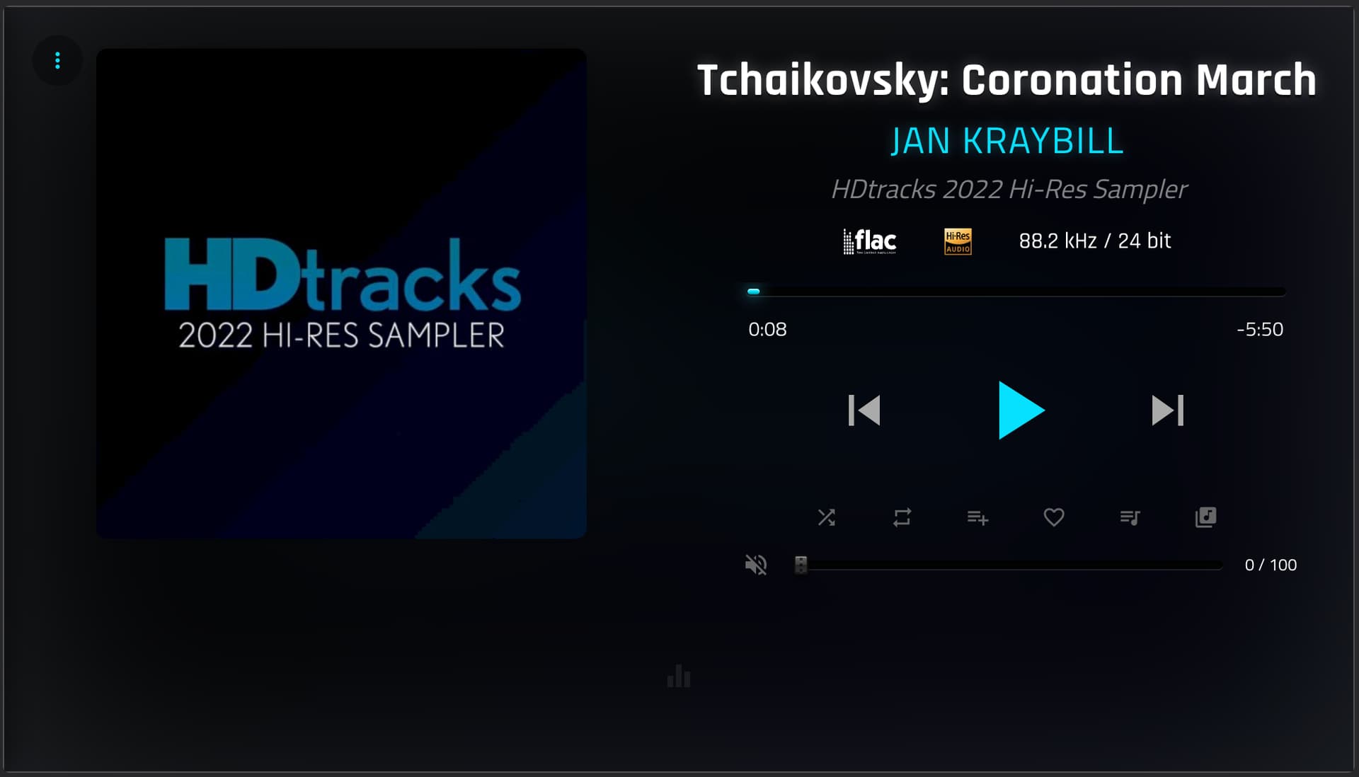

I just signed up for a Tidal account and tried many tracks including HiRes (24/96) and it all works Peppy Meter, Spectrum, Viz, all works.

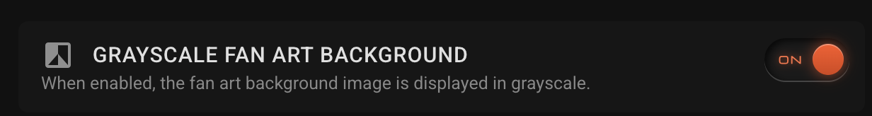

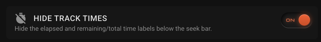

1.3.4
  • Added Greyscale Fanart TV background setting for better clarity of title / album name
  • Added Hide Track Times settings for minimalist look

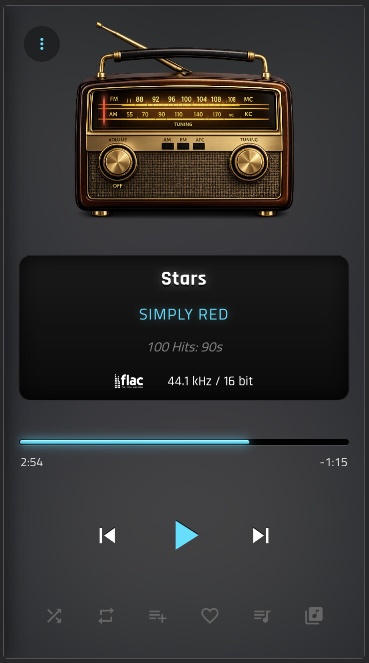

1.3.7 Stable version out now.
  • New radio player graphic
  • Mobile layout fixes
  • Other style fixes
