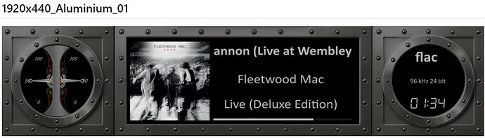

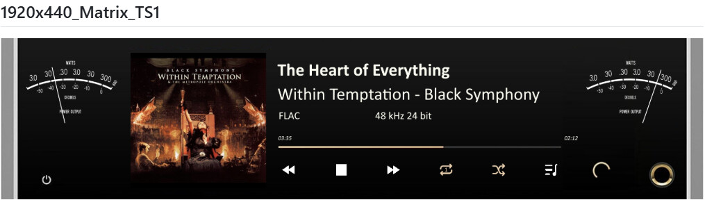

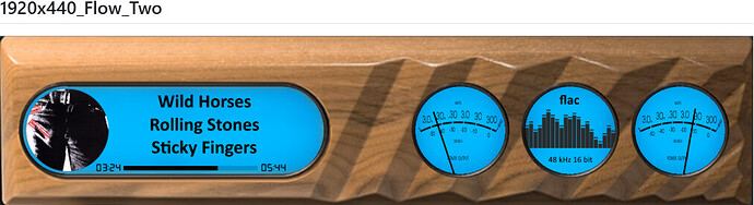

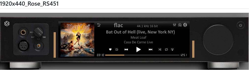

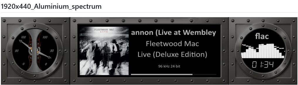

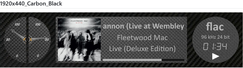

Added a few templates for a 1920x440 screen:
Where to buy, click here.

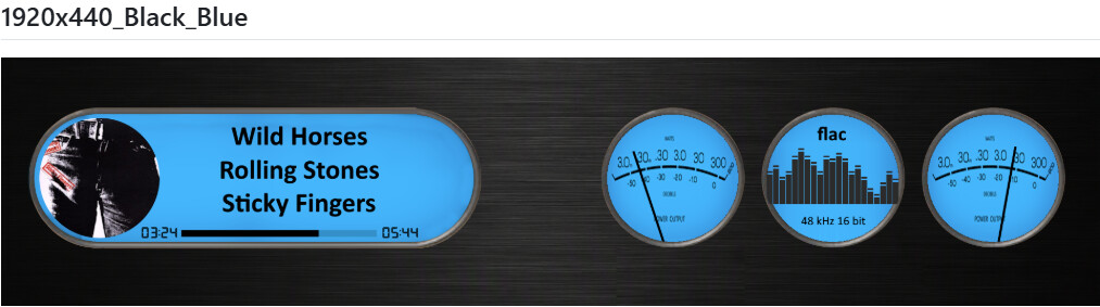

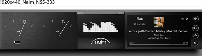

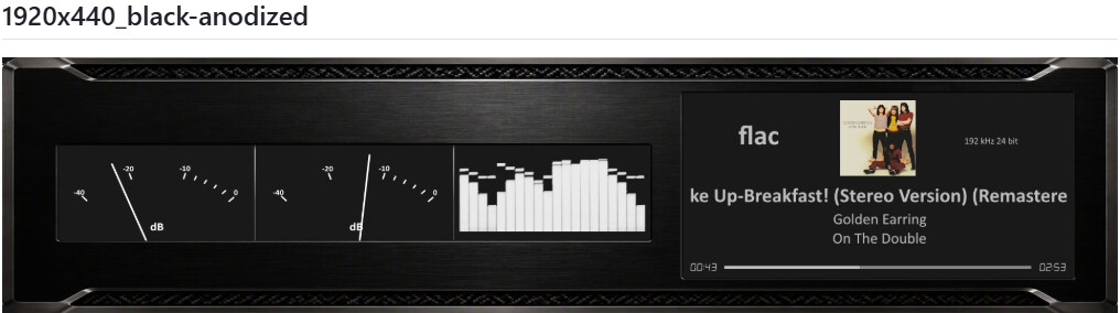

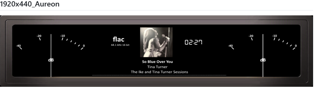

And my last upload for this screensize:

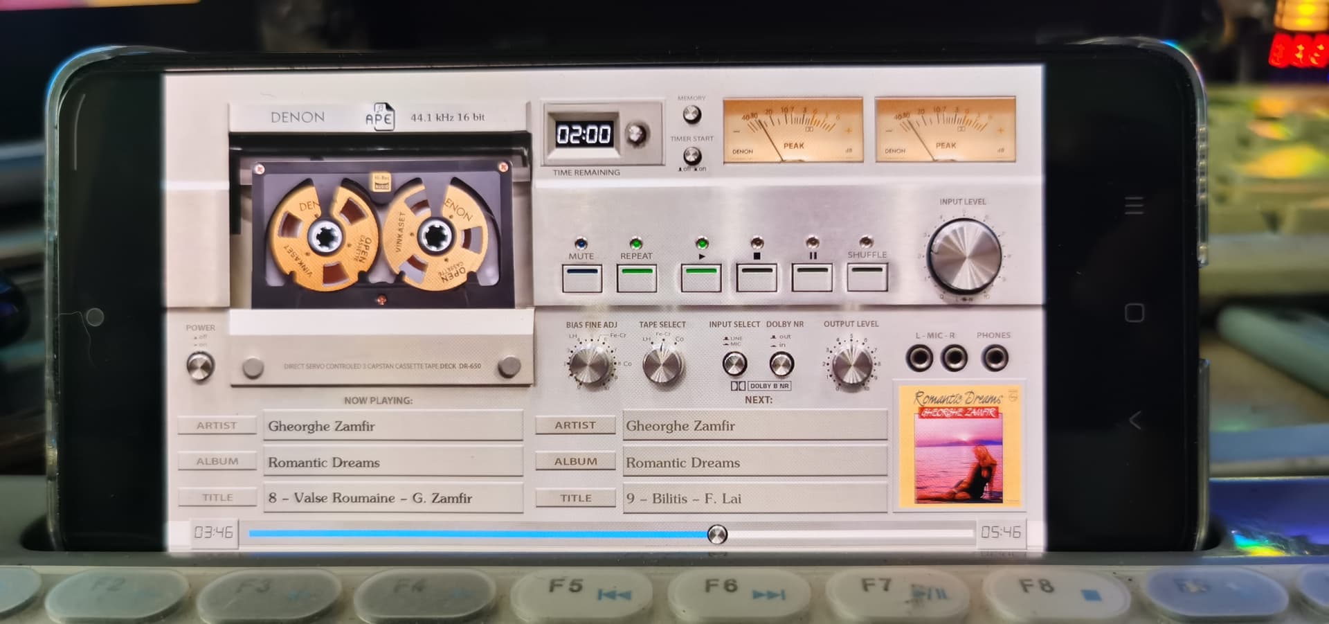

In practice, I used an external USB keyboard. The on-screen keyboard of a phone or tablet does not work very well with Pydroid3 (Pydroid3 terminal mode).
peppy_remote.zip (15.6 KB)
Unzip before use.
Nerd has just confirmed experimental version 3.4.4. This peppy_remote.py (included in the zip file) still works.

This reply assumes you have successfully installed the latest experimental versions of peppy_screensaver & peppy_remote and that they are running normally.
@nerd
Oh, I understand, thank you!
You’ve already patched the spectrum data transmission in the experimental version.

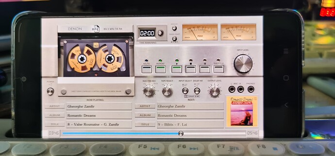

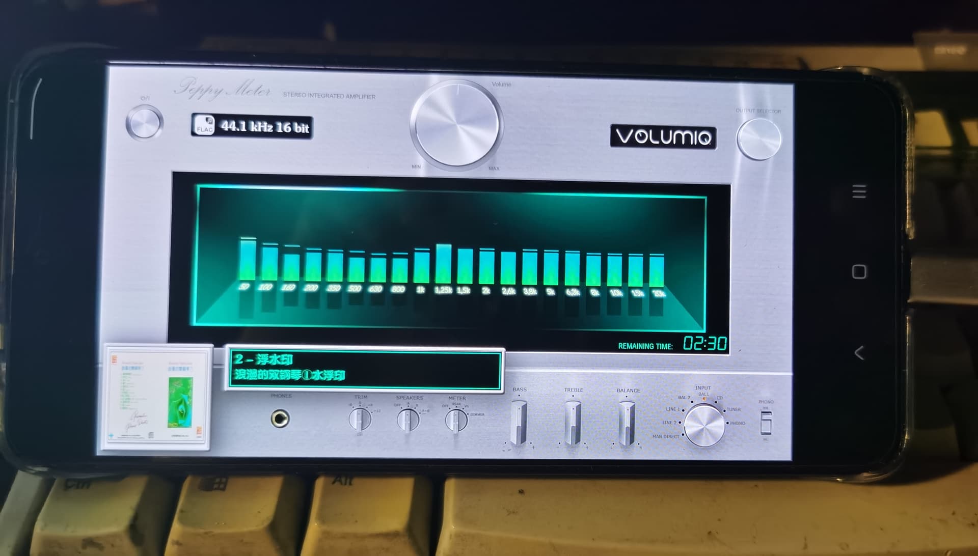

Just finished testing, and all functions are working correctly, including Remote Display Server → Always Stream Spectrum Bins.
The issue with the spectrum display is now perfectly resolved. When I finally got peppy_remote running on Android, the new meter initially wouldn’t work, and the app would crash. After resolving the crash issue, I discovered that all spectrum displays were missing. Upon closer inspection of peppy_remote running on Windows, the spectrum display seemed odd, unrelated to the music melody—it was purely a demo! Through communication with @nerd, it now runs perfectly. This is why I didn’t respond to everyone when it first started running on Android.

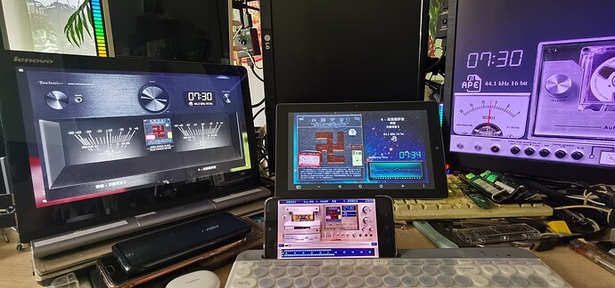

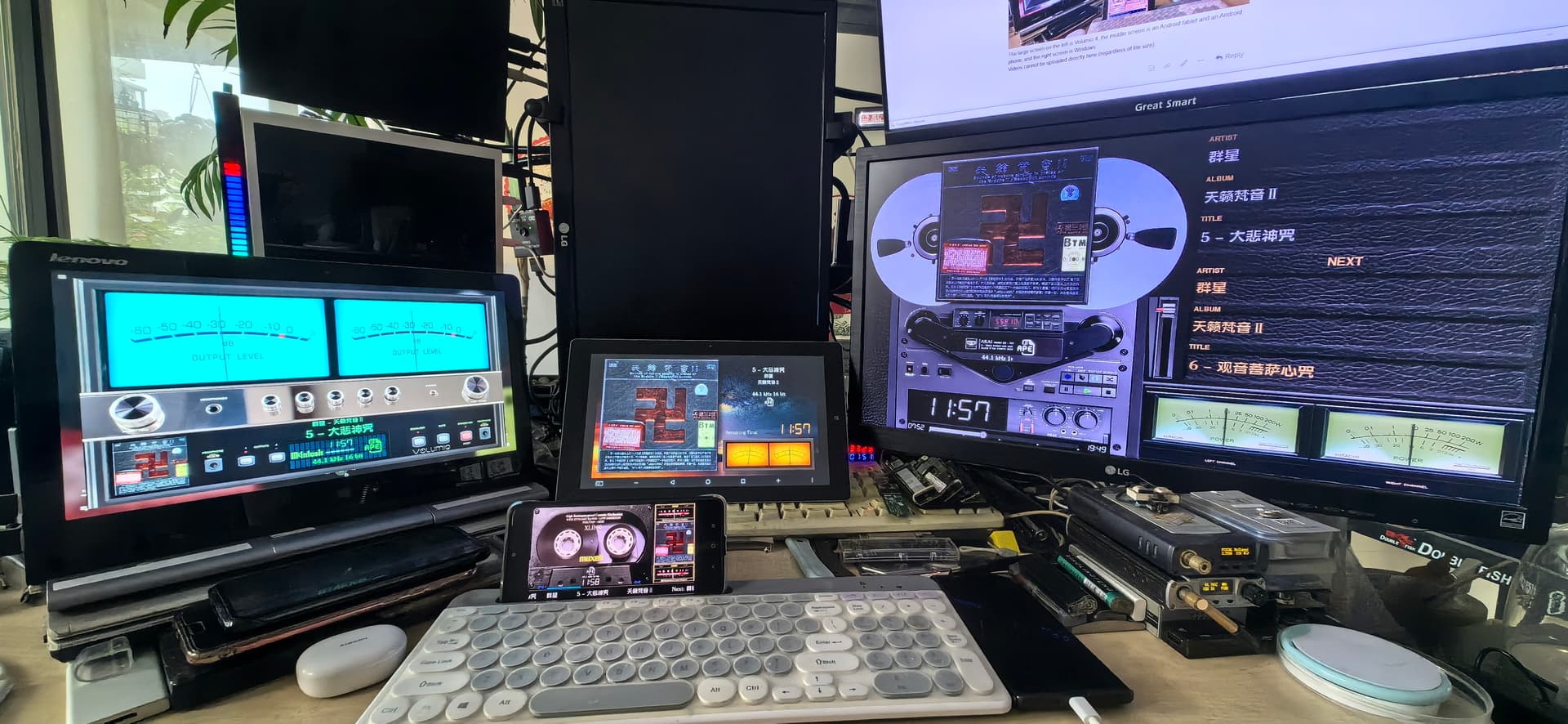

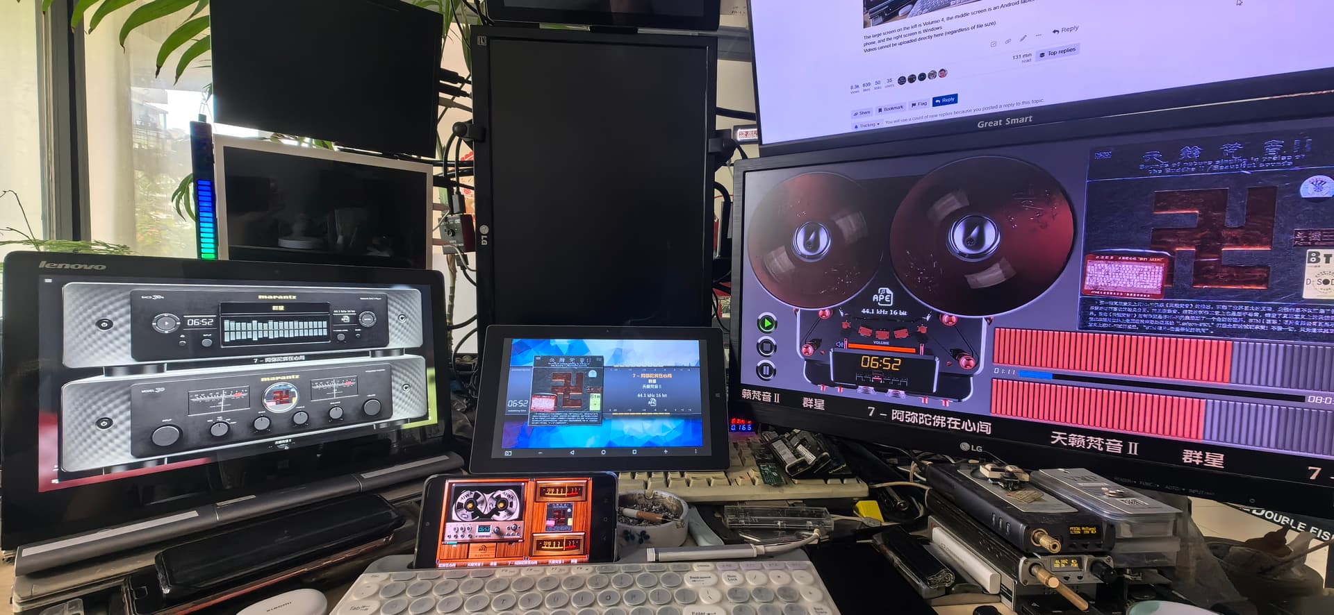

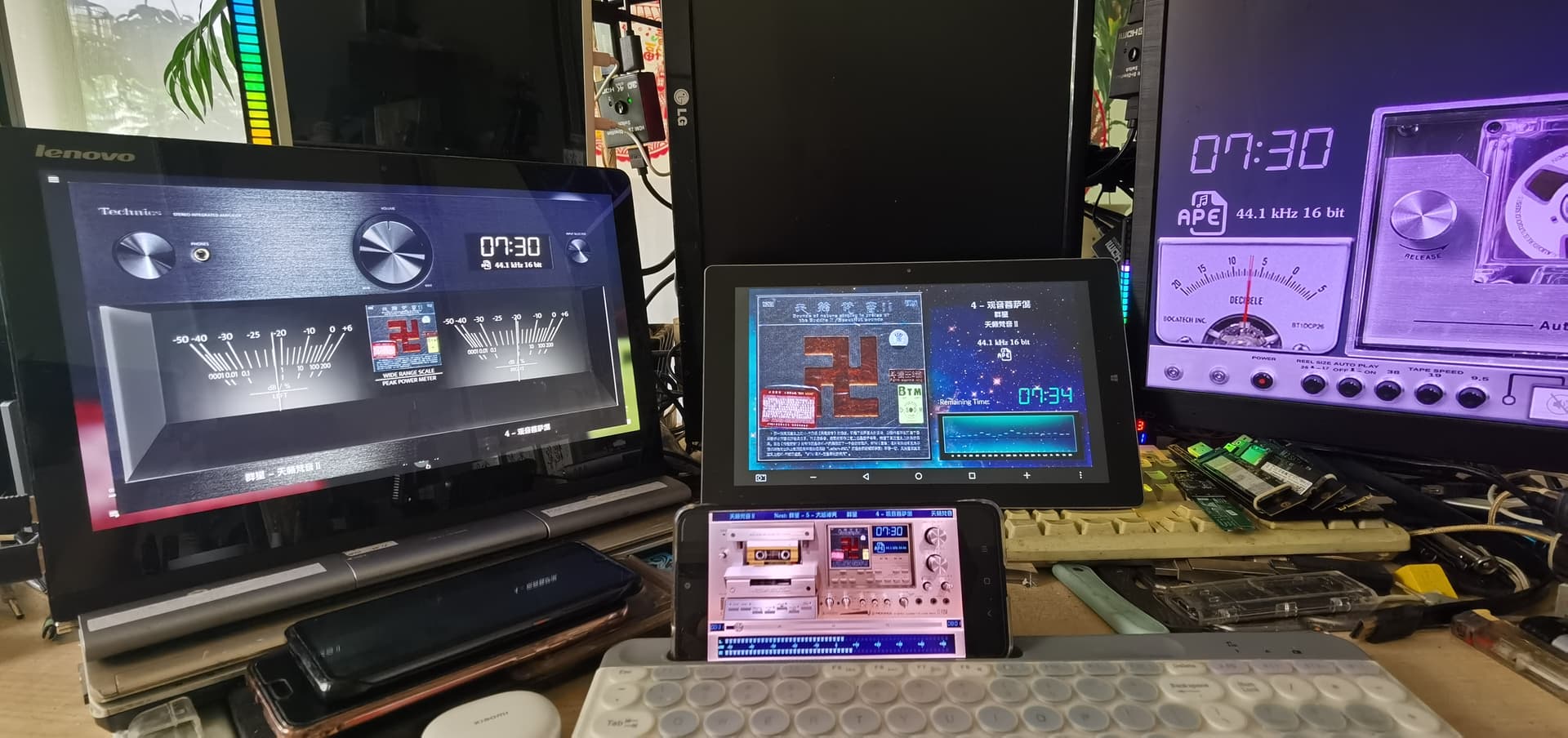

Peppy_screensaver & Remote display is a very entertaining plugin!
The large screen on the left is Volumio 4(The notebook with a touchscreen, Intel 4Gen 4G ram, is very smooth. The screen’s native resolution is 3840x2160, currently operating at 2048x1152, with a blurred border around the peppy_screensaver interface, which looks extremely elegant.), the middle screen is an Android tablet(x86) and an Android phone(Arm,Redmi Note13), and the right screen is Win10(x64).
Videos cannot be uploaded directly here (regardless of file size).
@Lee.Yan , I like you very much, listen to whatever music you want, but please don’t promote Nazi symbols.
You might be mistaken; please take a closer look. This is a Buddhist symbol—it predates Hitler’s version by a very long time. The orientation is different, and it conveys a sense of dignified composure—solemnity rather than evil…
It’s not surprising, though; Westerners often lack an understanding of Eastern culture, so many people misunderstand it.
Album Title: Ethereal Sanskrit Chants II (天籁梵音 II)
