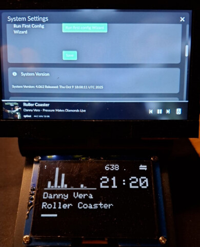

Thanks again. I got the 2,42 inch display as suggested above. What display type should i use? adafruit i2c 128 x 64?
And ordered these for a filter on the OLED, to make it a bit friendlier for the eyes.

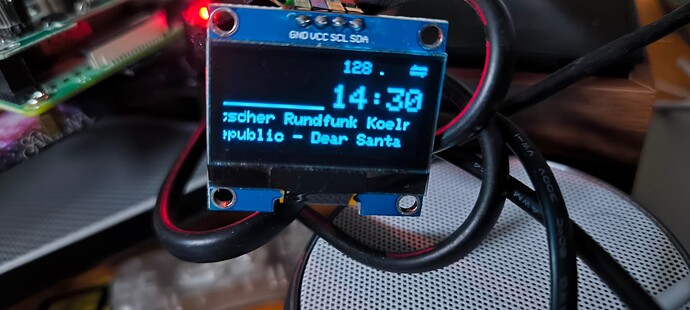

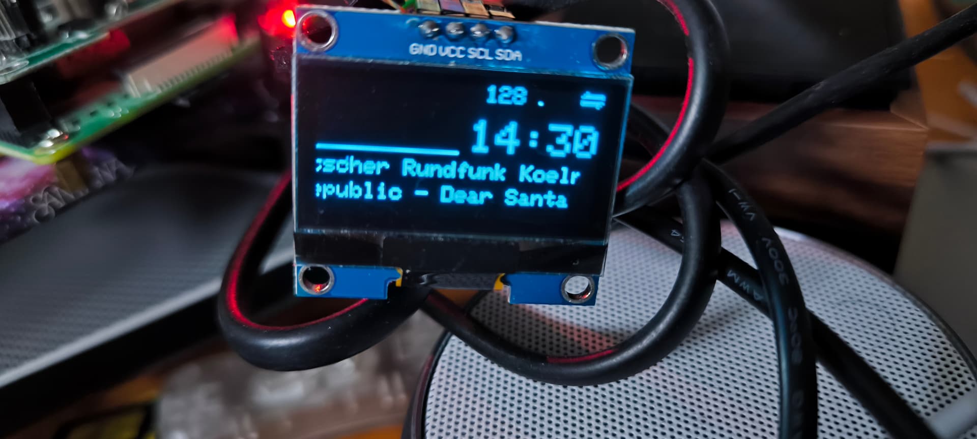

Hello to everyone!
I have the same problems with shifting upwords like someone here. I tryed to install mpd_oled_dev some times but was errror during building libu8g2arm. Is there a solution to this problem without installing mpd_oled_dev?
System as following:
Orange Pi Zero
Debiab Buster 10.4
SPD0301 (analog of SSD1309) I2C oled display
mpd_oled latest vertion
Regards
Sergey
Why installing the dev version and not the plugin from the plugin store?
Sorry, maybe I didn’t explain it correctly. I have this problem with the mpd_oled. I tried to install mpd_oled_dev to solve this problem.
What was the error?

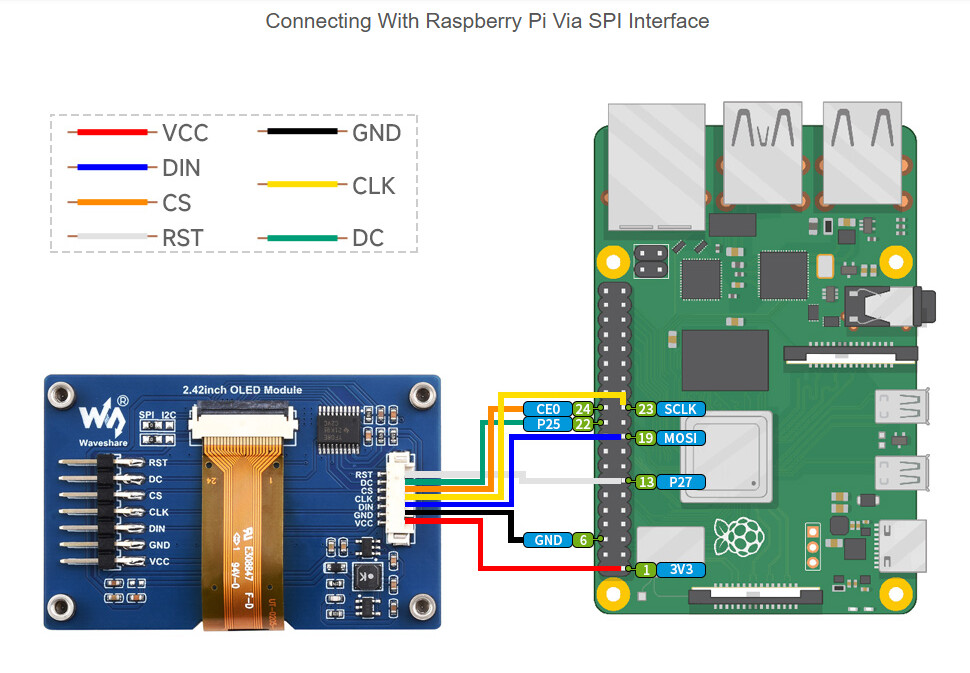

Hello everyone
I’m having a problem with the operation or settings of a 2.42-inch OLED display - 128×64 SSD1309 Driver Chip
connected to an RPI5 via GPIO.
The display is always dark/off.
The RPI5 is running Volume 4.119.
I installed and activated the MPD OLED 2.1.3 plugin.
I followed the wiring diagram attached in the plugin,
connecting the 7 electrical wires to the corresponding Raspberry Pi pins.
The SPI option in userconfig is ON.
I used a multimeter to measure the electrical connection between them, the power supplies (correct 3.3Vdc), and any defects in the display assembly (all OK).
Unfortunately, I consider myself poor at software; I’m more experienced with hardware.
I’ve tried various tests, using the Volumio forum and online, but to no avail.
I’m asking for help from anyone who’s had the same problem and solved it.
Thanks everyone.
This is the correct connection.
Your OLED works flawless with this plugin.
Is it possible you have damaged the OLED (apply 5V instead of 3.3V), as I don’t see a voltage regulator on the PCB?
