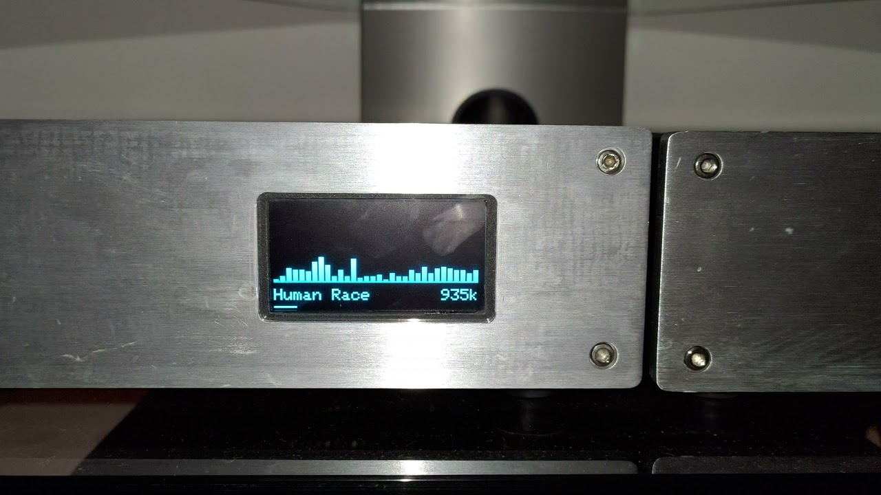

Hello all…
about always on display I’ve added an usefull option to turn off after some configurable time the display when player is stopped… Plus some nice customization…
You can see here…
And here my source…
master branch work fine on Volumio2 and moode branch work fine on last MoodeAudio
I know that the script to change configuration is not much elegant, I don’t know how do in better way, but I can easily lunch it with irexec and can change visualization with IR
