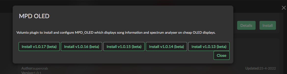

v1.0.15 with the delay has been pushed to the beta channel
The delay has been added to the mpd plugin service bash script which checks for mpd to be running, just like in @Adrii launch script check.

tested with beta v1.0.15, exactly the same problem with the only change that the mpd plugin is now disabled/inactive after a reboot.

I made a mistake which I’ve now fixed, try v1.0.17 when you get a chance cheers!

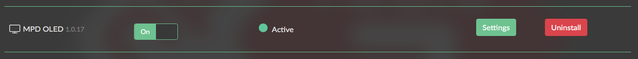

now the screen does not turn on at all, even after pressing safe.
stuttering stream is also still present even after pressing safe in the mpd plugin.
mpd plugin is only active after a reboot

and now i have a problem, beta 1.0.8 is gone from plugin store and this is the only version that works for me.

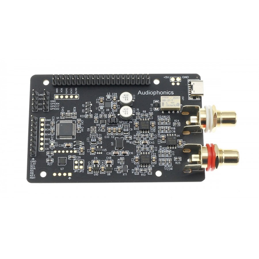

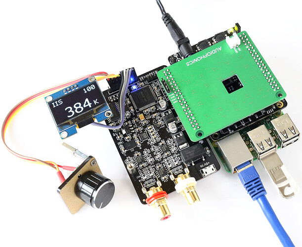

by the way I am making a streamer for my nephew and it uses an audiophonics Saber ES9038Q2M dac.
now an oled screen is included as standard.
is it possible that this mpd oled plugin also works with this type of dac and oled screen that goes with it?
iit uses i2c-SCK/SDA but on the dac board itself.
I think it would as it’s using I2C which uses the standard pins. It also looks like the same type screen that most of us have used too!
