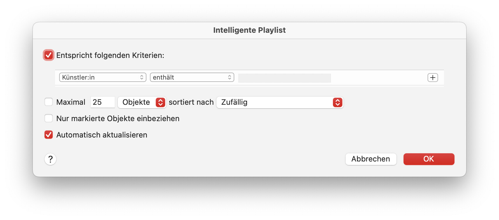

Yes, it looks like that. What about changing the plugin to have free choice of the variable you want to use to control the gpio? I am thinking of an interface like creating a smart playlist in Swinsian or iTunes. Using this kind of interface makes it possible to choose between many variables without wasting much screenspace, have a clean look and you can add whatever variables you want, you can even make a genre switch the light on your streamer :smile: i´d love to see that.
e.g.: the bitrate would be a good variable to do the same as the “play” “pause” variable does in my case.
Looks awesome! The problem is the user interface that plugins can create is very limited and you wouldn’t be able create anything like that.

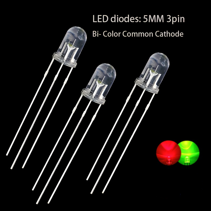

Then, with a two-color LED ( red and green ), you can control play, pause, and stop.
LED Bi-Color Common Cathode.
Red Anode - GPIO Pin 16
Green Anode - GPIO Pin 6
Cathode common - GND - any Pin
Play: green LED lights up - red LED turns off
Stop/Pause: red LED lights up - green LED turns off.
I hope I explained it understandably.
Not possible as you can only control one GPIO when a volumio even occurs :worried:
