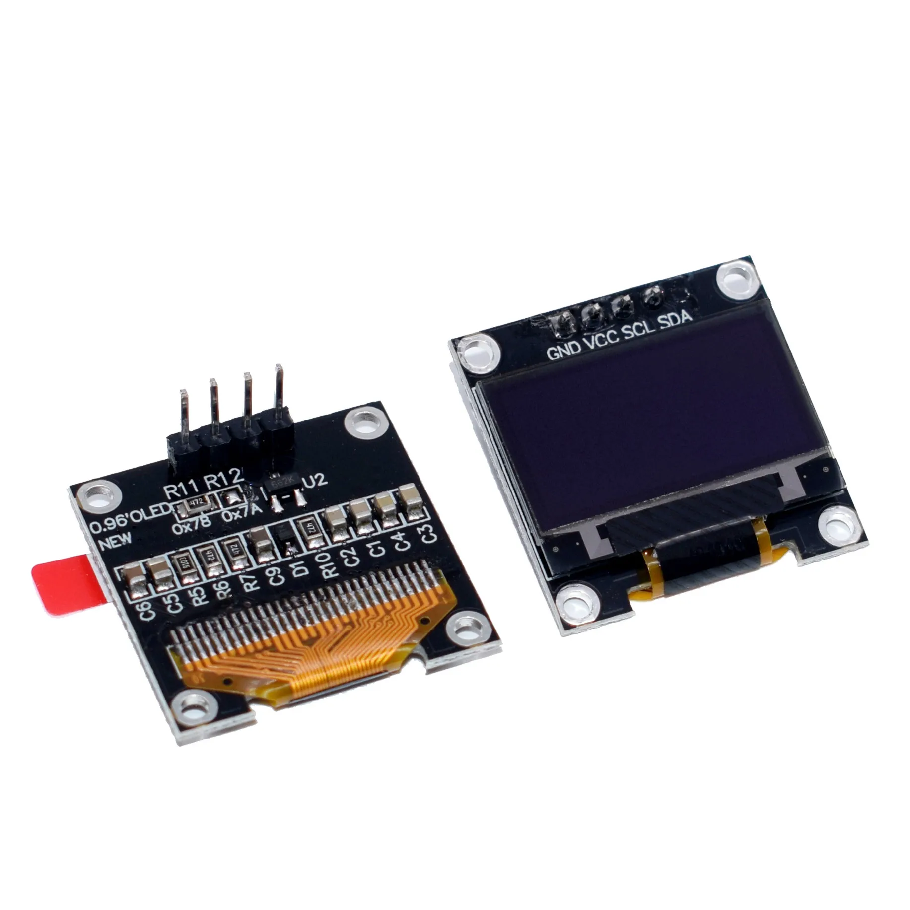

Please recommend me from ali express 3 I2C oled display
  1. 0.96 inch 128x32
  2. 2.42 inch 128x32
  3. 0.91 inch 128x32
I see a lot of models and since theshippmend takes long I want some models that I know you have used in your projects and works.
Many thanks for your support, I am new in this dyi projects also in rpi world but I like it and I am planning to build 1 streamer with 5 inch dsi interface and 2 3 radios with pi zero with Darmur project.
Florin
Hi Florin
The display needs to be 128x64. I have previously bought generic 1.3" I2C SH1106 displays from ebay, e.g.: https://www.ebay.es/itm/White-1-3-OLED-LCD-4PIN-Display-Module-IIC-I2C-Interface-128x64-for-Arduino-UK/192413255024?ssPageName=STRK%3AMEBIDX%3AIT&_trksid=p2057872.m2749.l2649 they have all worked fine with mpd_oled. I bought a generic 1.3" SPI SSD1106, and this also works fine. Some people are using a 2.42" SSD1309 with I2C, and I believe also SPI. I am not aware of any models of the supported display types that do not work with mpd_oled.
Adrian
Why there is written for arduino?
So can I choose any size as long as they use the supported controllers?
Arduino projects also use these OLEDS, e.g. https://www.instructables.com/id/Monochrome-096-i2c-OLED-display-with-arduino-SSD13/
The physical size of the OLED doesn’t matter, it should just need to be I2C or SPI, 128x64, and with an SSD1306, SSD1309, SH1106 or SSH1106 controller. I can’t guarantee that any individual display will work with mpd_oled, but if you see a display that you like and are unsure if it is supported then feel free to post the link.
If you’re going to use I2C OLED screen together with BassFly-uHAT (the project I released), you need to take exactly this model: 0.96" I2C OLED DISPLAY MODULE 128X64 SSD1306
If you take a bigger one it will not fit with tactile buttons, mechanical design has been done with that model in mind. Furthermore, according to the documentation of mpd_oled add-on, resolution must be 128X64
If you’re going to order PCBs from PCBWay, you will find the OLED module on their bazar, you can order that one and have it shipped together with PCBs.
https://www.pcbway.com/project/gifts_detail/I2C_IIC_Serial_128x64_OLED_Display_Module.html
