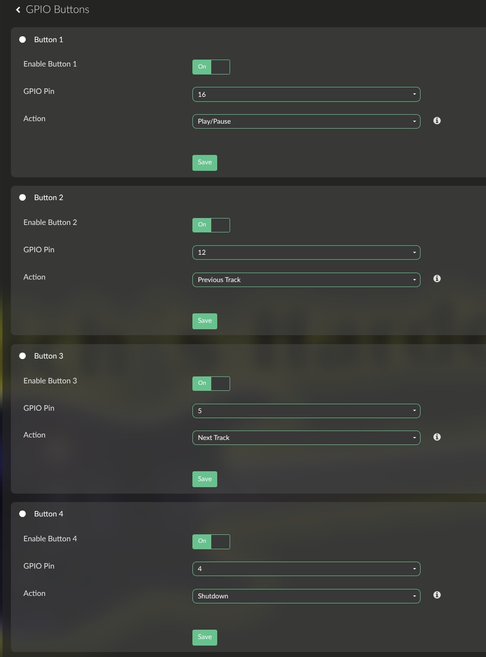

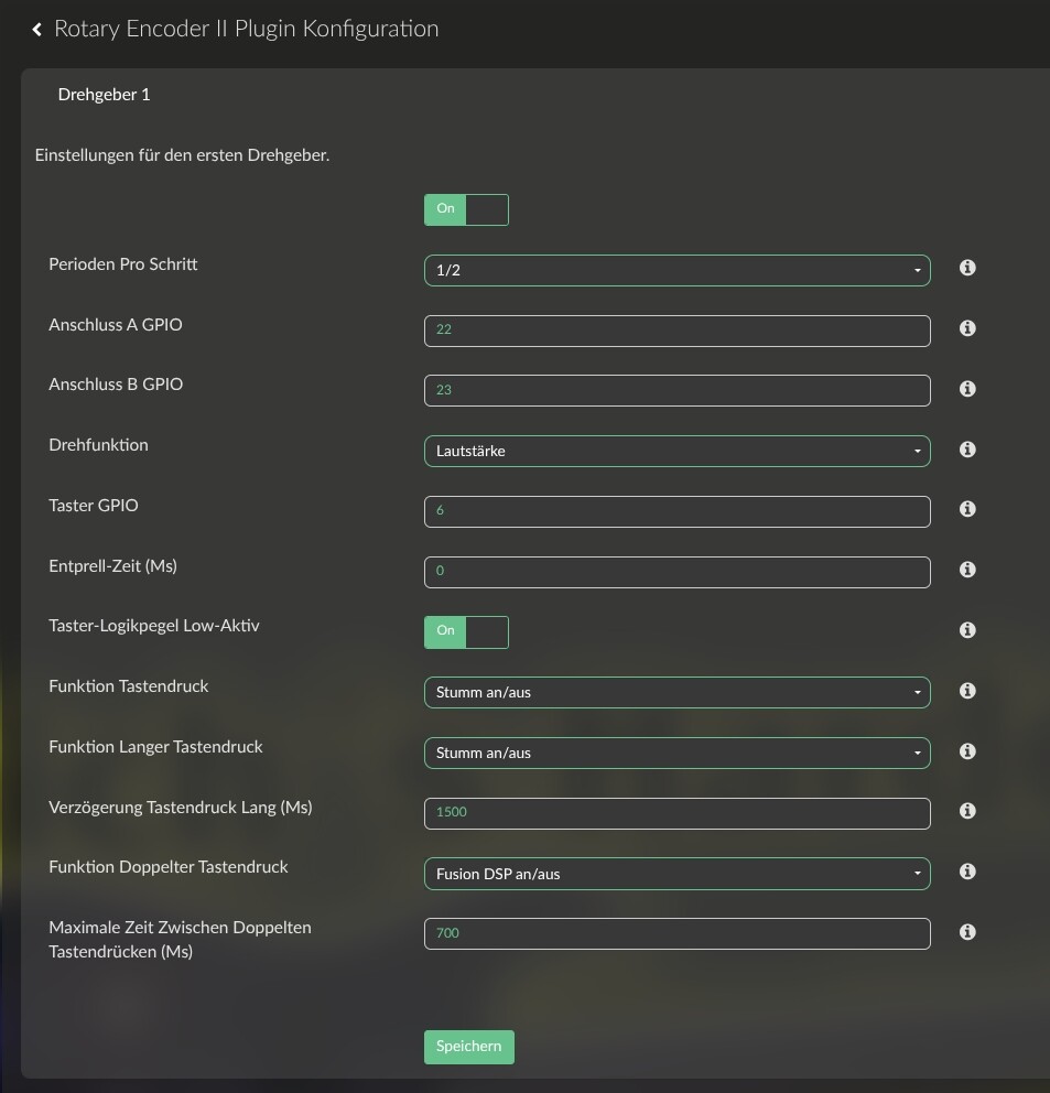

the buttons & volume-knob are done with the GPIO-Button & Rotary-Encoder II plugins:

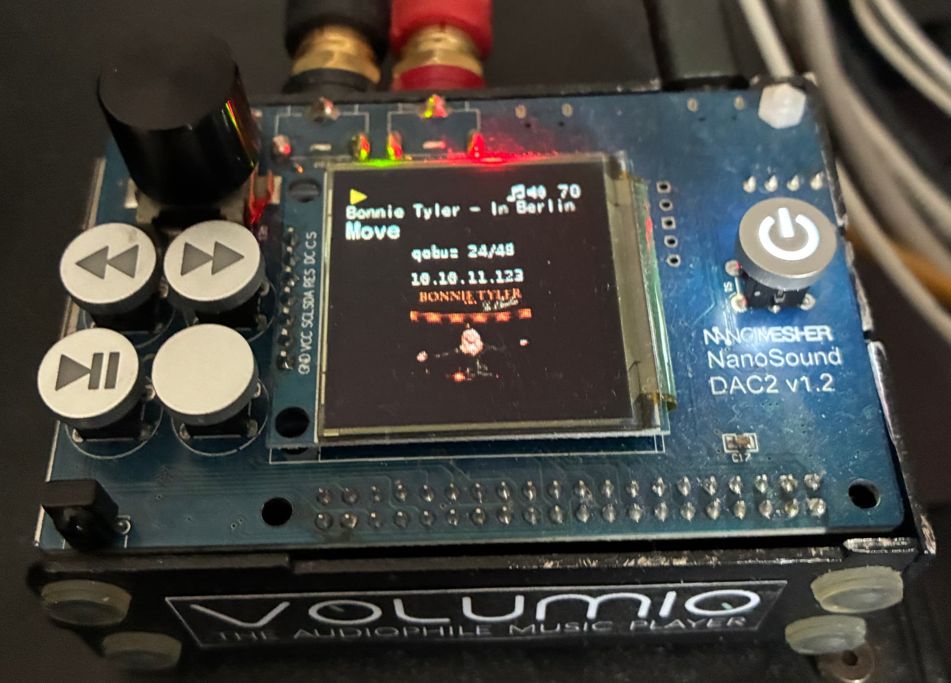

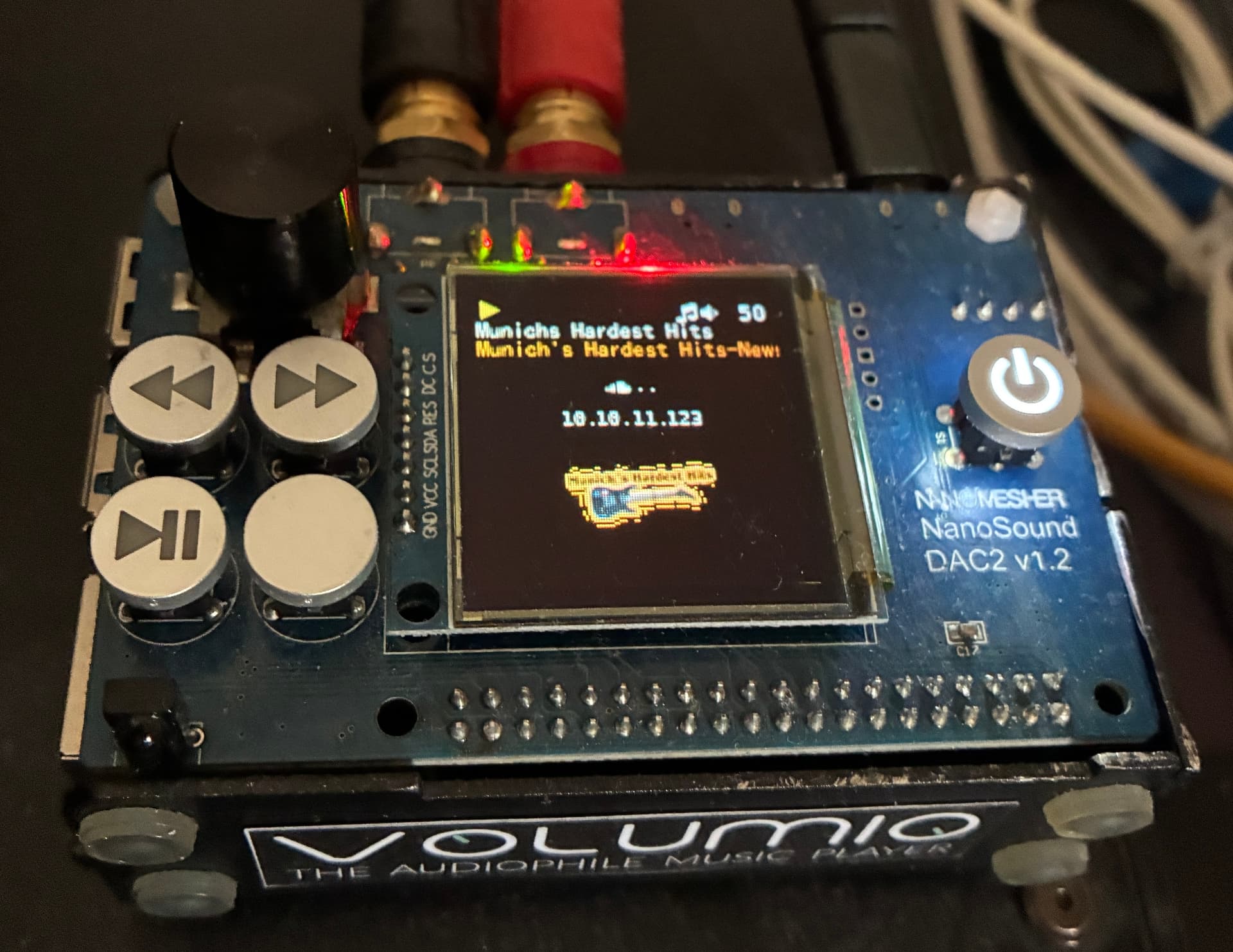

the result @ daily working here:
