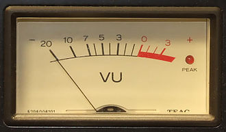

Hi everyone,
I made some skins of circular meter for my 1560x720 display. Everything works fine.
I have a question, I want to put in my meter LED peak detector, like it was in some old VU meters.
Is it possible to do it?
Or is it possible to put in one meter both, circular and linear meter?
Thank you in advance.
