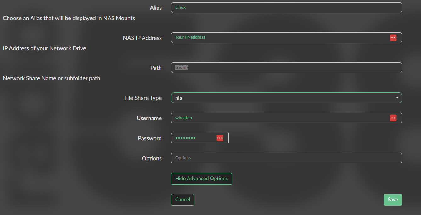

Linux server folder doesn't mount on the RIVO+ software
Hi, I am trying to add a shared folder my linux Ubuntu server to my fresh Rivo+
I am using a web browser to access the Volumio software on my Rivo+
Rivo+ is updated using that function in the Volumino software.

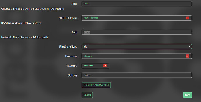

I can choose the folder from my server. When everything is configured and I save there is a pane requesting username and password, though i filled it in already. When done there is don’t get a fault message, but the red cross under “Mounted” remains.
I can totally acces the share on the server on my laptop (linux)
BTW the version SMB 3-11 is recognized by the Rivo+
Let me recap:
  • You have a shared music folder on your Ubuntu server
  • You want to mount this share on the Rivo+
Question 1:
  • Why opt for Samba (Windows thingy), if you can use NFS?
I am not that affluent in Linux, It is the way it is set up I think. Else I would have to study a bit on it
Well first, is my recap correct?
Yes, I confugured the server in smb.conf file in linux

O.K. I have to check something first I think.
I have to do some chores first right now.
O.K. I thought I made a mistake, but I didn’t.
Seems to be a problem with authentication?
Perhaps should try temporarily guest access I guess.
On the Linux server (not on your Rivo+):
Install NFS server
sudo apt install nfs-kernel-server
On your shared music folder: (here the shared folder is /srv/nfs)
sudo chown your_username:your_group /srv/nfs
chmod 755 /srv/nfs
Configure exports
sudo nano /etc/exports
add: (if your network mask is different make sure to modify 192.168.1.0/24)
/srv/nfs 192.168.1.0/24(rw,sync,no_subtree_check)
ctrl+o => enter => ctrl + x
sudo exportfs -ra
sudo systemctl restart nfs-kernel-server
Mount on Rivo+
O.K. Using the samba server is not a viable option?
I would have to dig into linux a bit again: refresh memory and study more.
Can the NTFS run besides the samba server?
Off course i would remove first the music folder from the samba config
If you setup a share between Linux boxes (server and Rivo) Samba (Windows) makes no sense.
It adds unneeded overhead, NFS is the way to go.
You can leave samba as is, just don’t use it.
Not sure why you use NTFS (Windows) in a Linux environment but it should work.

Ha! So that would be an improvement: nice!
BTW you mean NTFS instead of NFS?
NFS stands for Network File System.
In simple terms:
NFS lets one Linux machine share a folder so other machines can access it as if it were a local folder.
Ah, I see. I will manage. Thank you very much again!

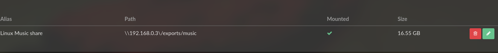

So, we have now connection via nsf
