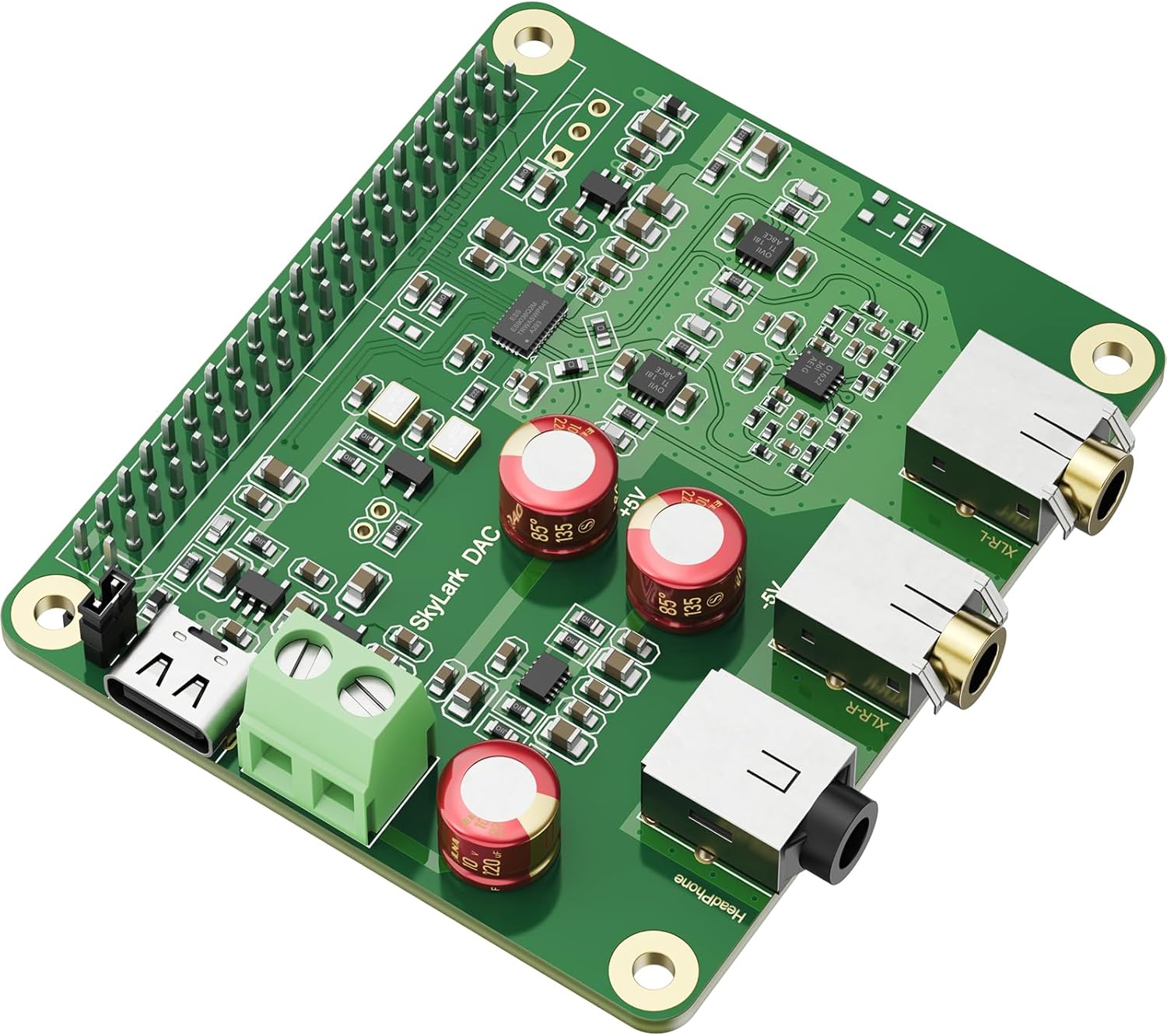

Inno maker DAC Pro Hat ES9038Q2M
Hello everyone.
I have had this dac for a month and in terms of sound quality it is perfect for me, but I have the following problem:
I am currently using the stereo minijack output from headphones to RCA, since my amplifier only has RCA, the problem I have is that the music is heard in the background on the rest of the inputs on my amplifier when I select them. I don’t know what this is due to, perhaps a grounding problem on the minijack output?
The thing is that I would like to try the XLR output, but it is not clear to me which cable I should use. I have seen these adapters:
zdyCGTime RCA to 3.5 mm Audio Adapter, 2-section 3.5 mm Mono Male Connector to RCA Female Connector. (2 Pieces) zdyCGTime Adaptador de Audio RCA a 3,5 mm,Conector Macho Mono DE 2 tramos 3,5 mm a Conector Hembra RCA.(2 Piezas) : Amazon.es: Electrónica
I would appreciate if someone could tell me how to make the XLR to RCA connection.

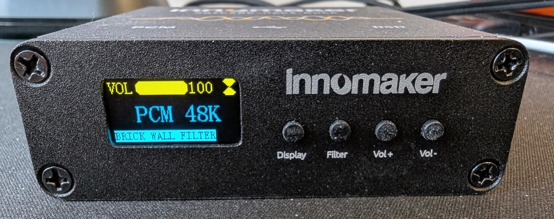

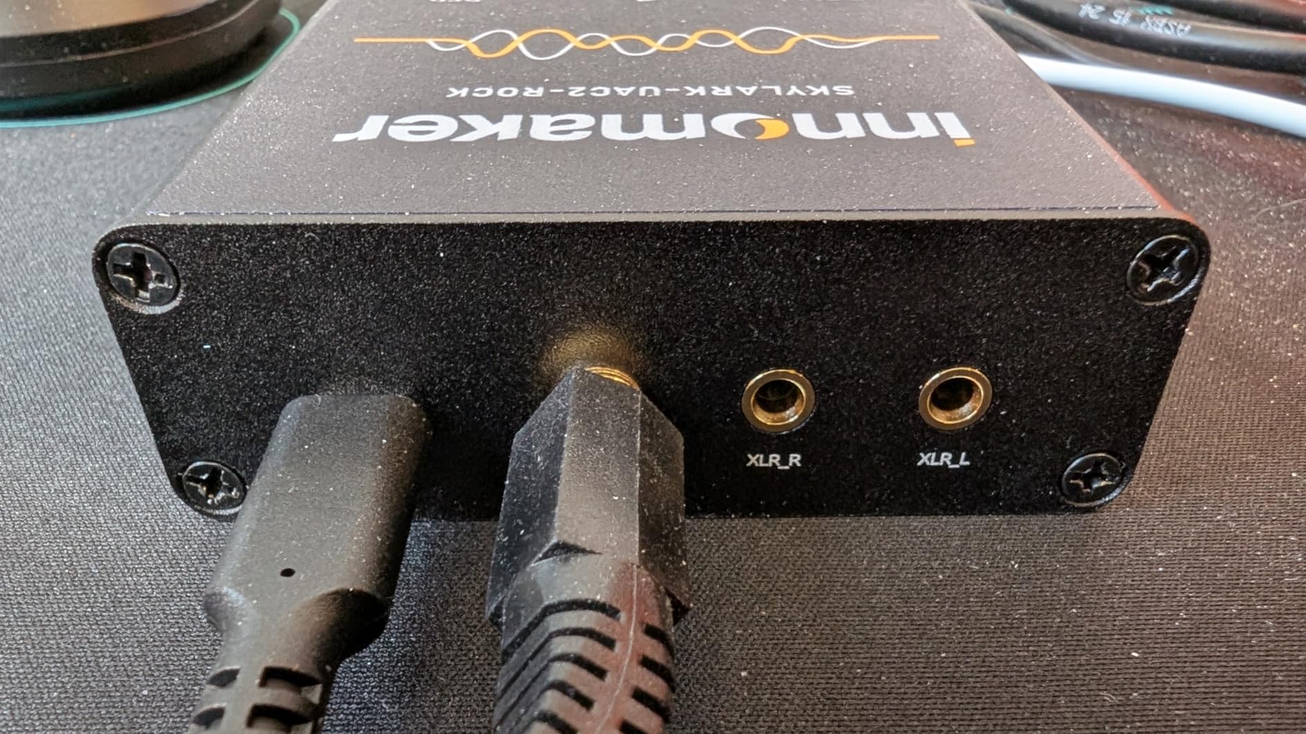

New / old product - version DAC USB Innomaker with ES9038Q2M ?

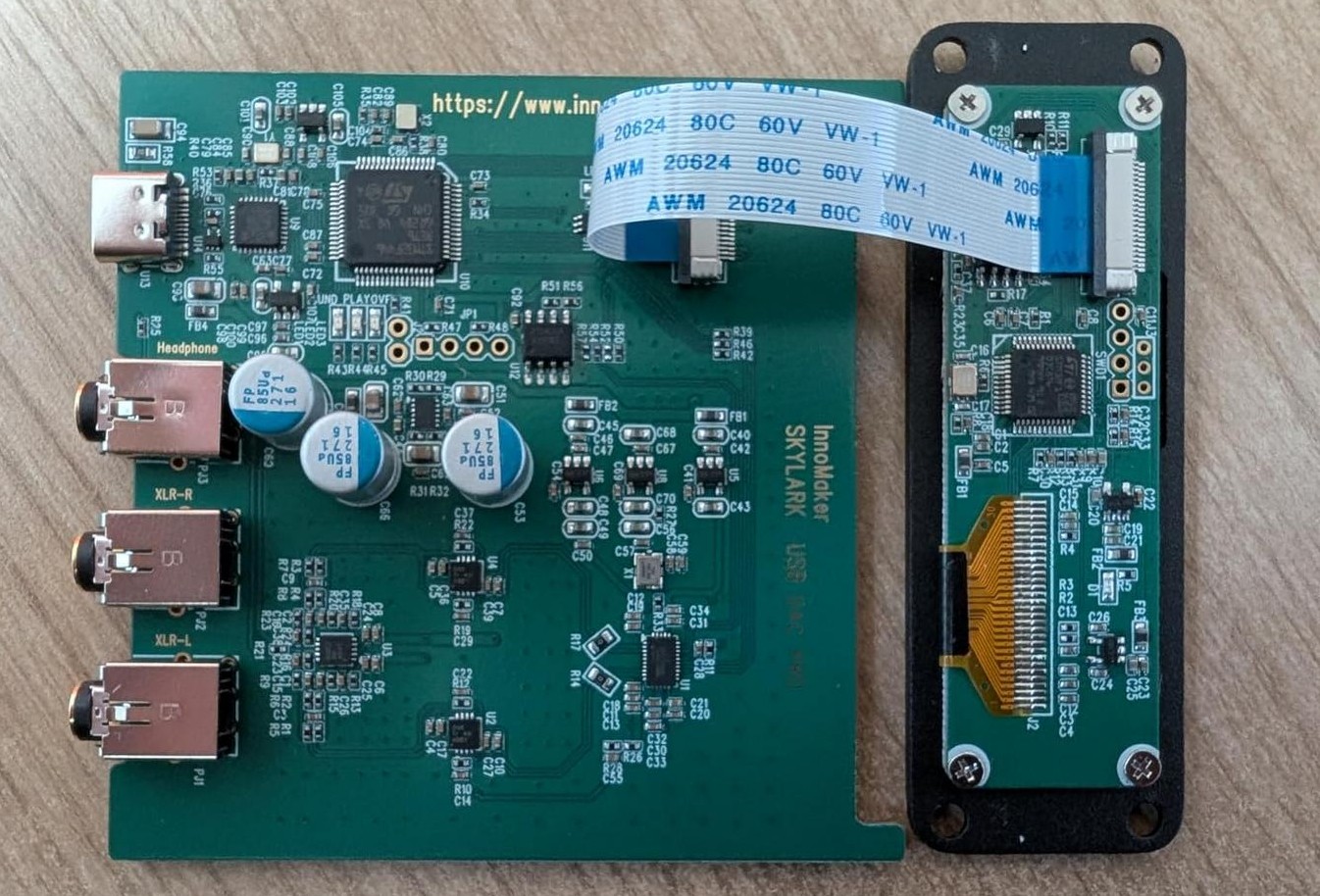

Interesting find! it looks like the DAC Pro Hat + a DSP board:
It’s using an STMicro USB interface chip.
Yeah, mine is arriving today.
Not sure how this can sell for 30 Euro less, with a case, buttons and LCD, than Inno maker DAC Pro.
