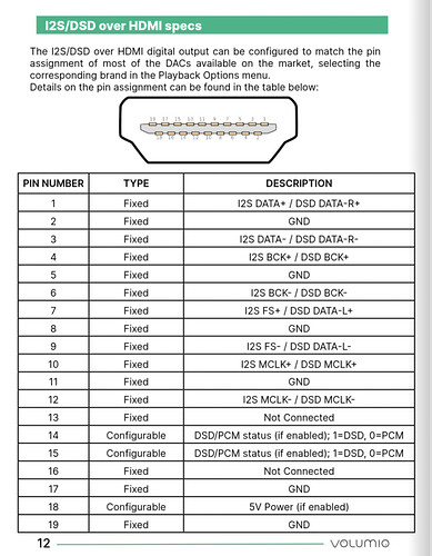

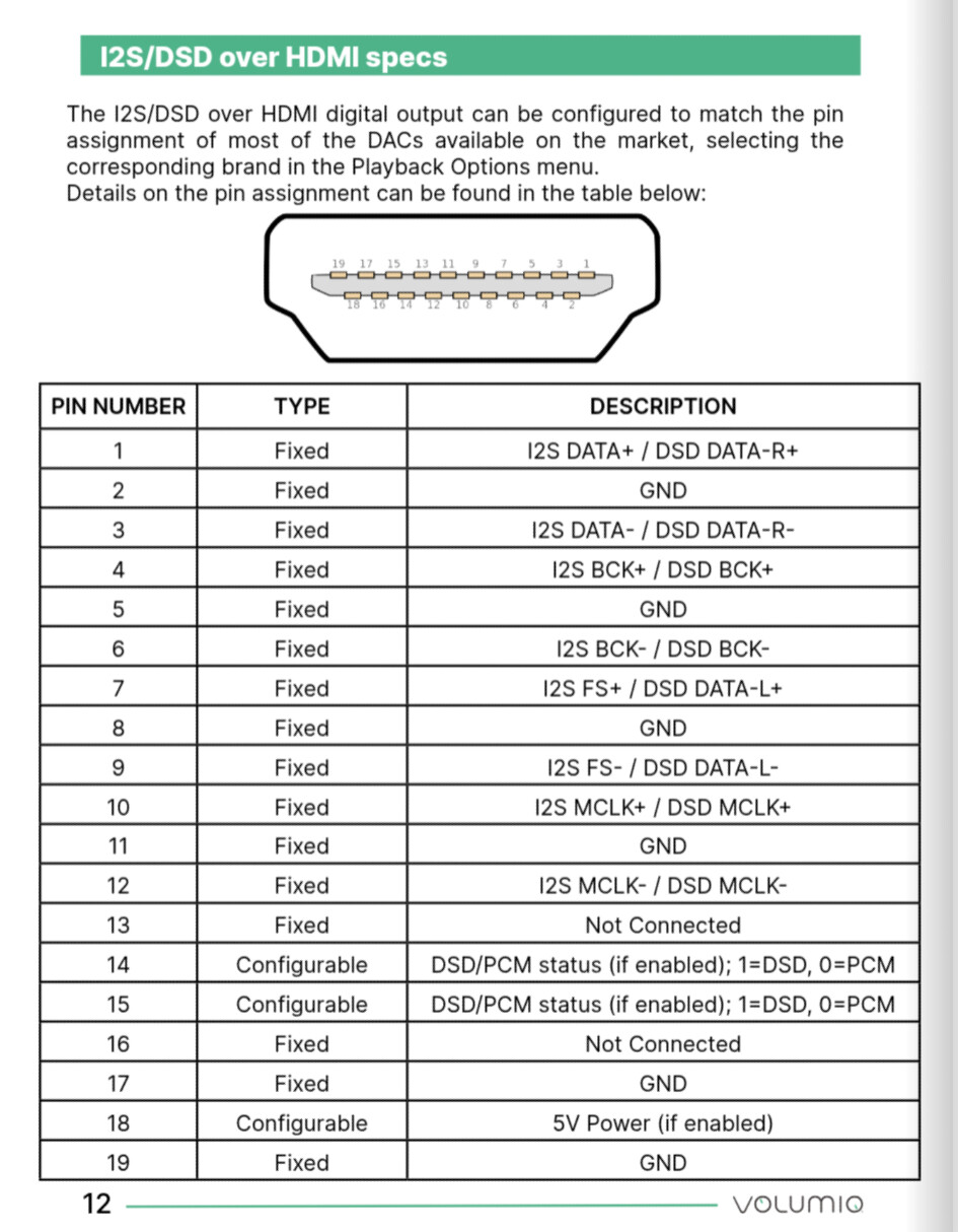

I will get back to this reply later. Meanwhile Denafrips is asking for the pin out diagram for the Rivo+ I know it has six options. I am using Denafrips. But that doesn’t tell me what the exact pin out is. Could you provide de pin out diagrams for all six options on the Rivo+
from the user-manual
Selecting “Denafrips” from the drop-down menu on the Rivo Plus, pins 14/15/18 are tristate (no signals on them)
if you select “Volumio”, the PCM/DSD signal is on Pin14 (Pin15 and Pin18 are tristate)
if you select “Loxjie”, the PCM/DSD signal is on Pin15 (Pin14 and Pin18 are tristate)
