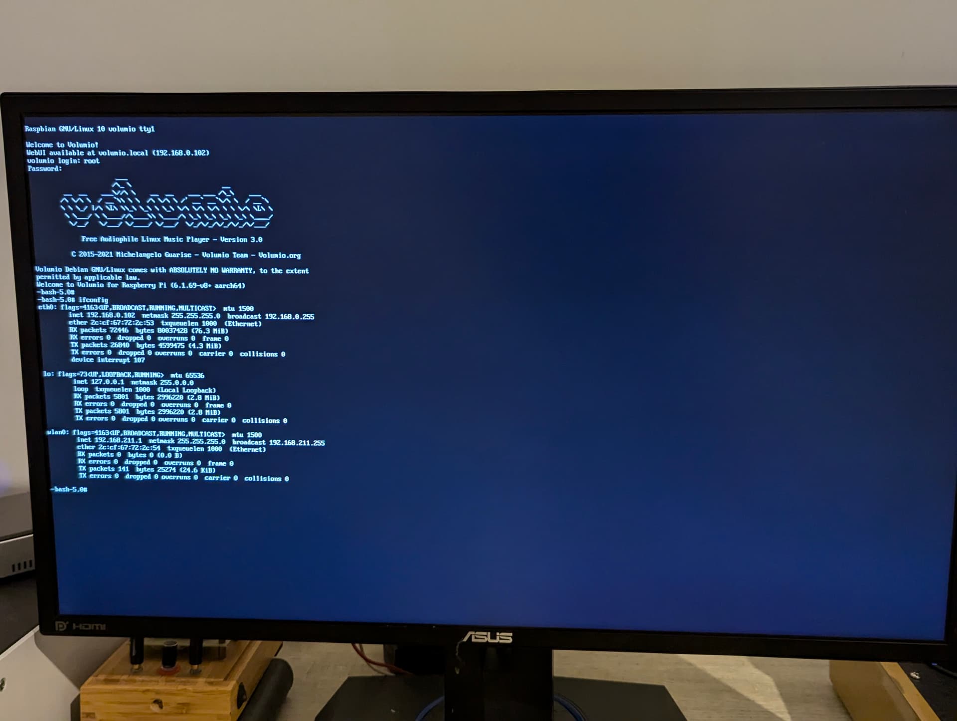

Just bought RPi5 , installed volumio through RPi imager. Installed successfully but can’t get volumio UI on my monitor thru HDMI.
You have to install the plugin touch_display in order to get the UI on your display
