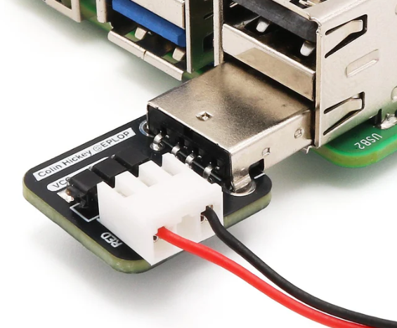

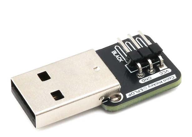

Some aditional information after a few days …
The alsa error was due to a lack a patience from my side. I just have to wait some seconds to have alsa started ! It was reported in a couple of posts !
In adition I found also that part at the pihut webstore in order to plug the screen directly to USB port and not on the GPIO pins from the hifiberry. Very usefull for a very small price ! (search : “USB Power Breakout for Raspberry Pi Touch Display 2”)
So very happy with that new Display
Thanks again for support
