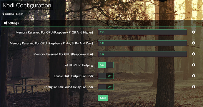

Thanks fai! Did you use the latest version I uploaded? You might need to wait a bit, if the plugin was installed seconds ago the pi can still be quite busy.
Attached you will find the plugin settings screen, please note that I made some last minute translation changes, these will be in the next release.
Hi, this should work out-of-the-box. :slight_smile: Because that is exactly my setup at the moment. :wink: Same goes for you, if you go into the settings page you will find the setting “Enable DAC output for Kodi”, if that setting it set to false you will have HDMI output for both video and sound.
