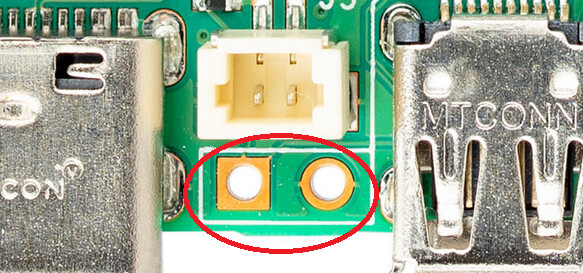

  • :white_check_mark: There are dedicated pads on the PCB for connecting an external switch.

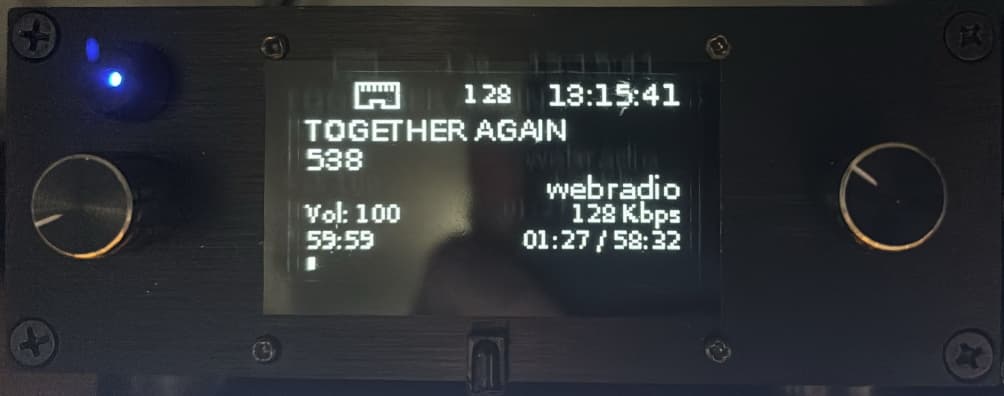

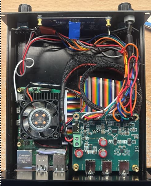

I am running a rPi5, with 2 rotary encoders, power switch, power led and 2.42 Inch OLED display.
nice set up.
i have the official 27 W Raspberry Pi power supply is there at difference from that to the 25.5 w
one off the led light are Connected to the gpio 16
Try gpio=12 for the led
8c92621d9c837514c6c443f2e829805ab5adf835

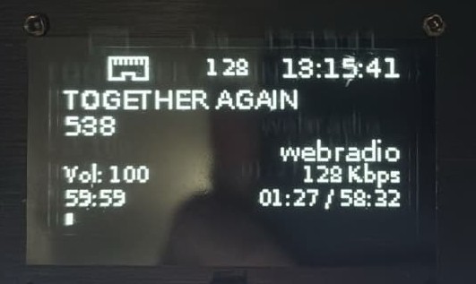

What plug in are you using to get this information on a 2.42" OLED display?
I have a 2.42" SPI OLED display and an MPD OLED plug-in.
But I’m interested in your version of displaying information on a 2.42" OLED.
This is something I programmed for personal use only.
Could you elaborate on how to do this?
What needs to be edited to change the display method?
Is this done in the configuration files in the MPD OLED plugin?
It’s completely written in Python, it has nothing in common with MPD_OLED.
