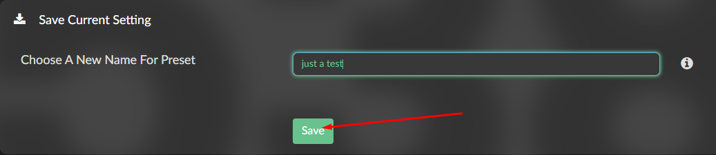

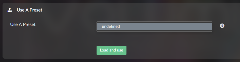

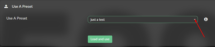

Volumio 3 doesn’t save FusionDSP presets (I use it with Rivo). I click on ‘Save’ but there’s no presets there when I want to choose.
(The same happens with favourites, but it is a smaller problem for me at the moment)
I have tried the web app and iOS app as well.
Any hints? Thanks.

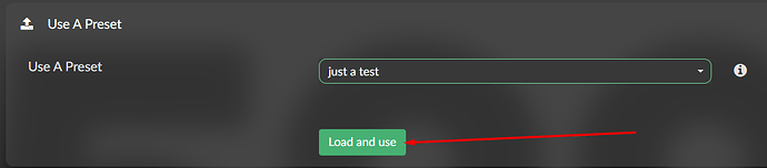

So you did do this?
And when trying to load it’s missing?

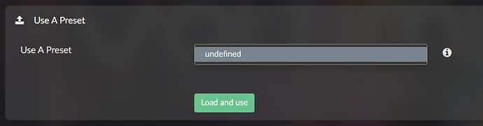

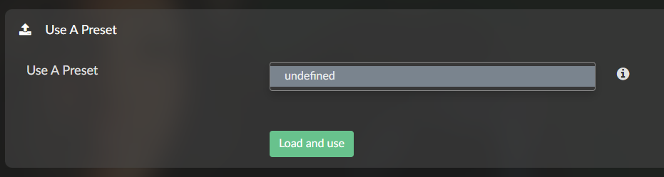

Of course I do it that way, it’s quite straight forward. But sadly doesn’t work in either the iOS or the web app. It shows “undefined” both ways.
Ok that’s weird, it should work without problems this way.

  • When up and running create a random DSP filter and save it under the name “Test_01”
  • Execute the steps to load the newly created filter (even though it might fail again)

I can’t do it because the preset isn’t saved, hence I can’t load it of course.
There’s only an “undefined” text in the field where the saved presets should be.

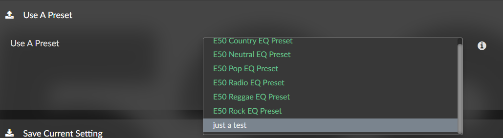

    In graphic mode, do you see Factory preset such as

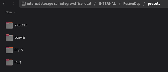

    Check if the shared folder exists
/INTERNAL/FusionDsp/presets
and contains sub folders
Can you write in this sub folders?
Do you see something in it?
If nothing exists, remove and reinstall the plugin.

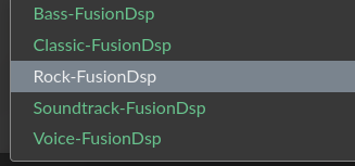

I don’t see the factory presets either:

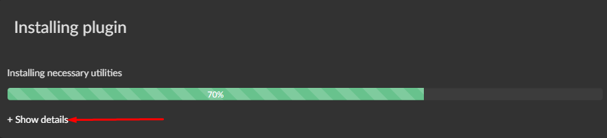

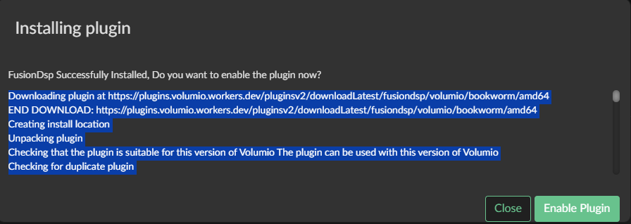

I believe @nerd already explained that the upgrade only changed the Node repository URL. Please remove FusionDSP, reboot, and reinstall FusionDSP. On the message click + Show details.
Before enabling it, copy the generated log from the message and post it here. It looks like your FusionDSP installation is failing, and without that data we can’t provide support.
If you re-install FusionDSP it will go faster as needed libraries have already been installed.
