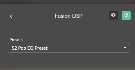

And magic happens.

volumio@rivo:~/scripts$ ./switch_genre.py
Genre changed: pop → Preset: S2 Pop EQ Preset
Updated config.json → PEQpreset = S2 Pop EQ Preset.json
Applied preset: S2 Pop EQ Preset.json
Genre changed: unknown → Preset: S2 Neutral EQ Preset
Updated config.json → PEQpreset = S2 Neutral EQ Preset.json
Applied preset: S2 Neutral EQ Preset.json
Genre changed: rock → Preset: S2 Rock EQ Preset
Updated config.json → PEQpreset = S2 Rock EQ Preset.json
Applied preset: S2 Rock EQ Preset.json

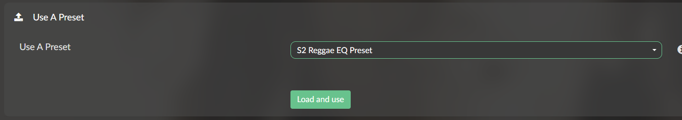

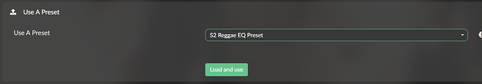

Only thing I miss or don’t understand. If I go to the plugin teh correct filter is loaded and applied. If I select the speaker icon, bottom right, it shows incorrect filter setting.

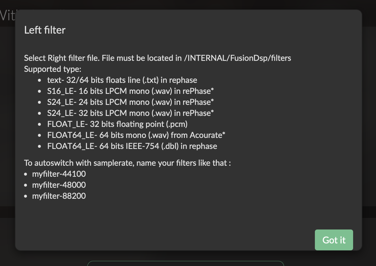

Greetings. Regarding convolution filter auto-switching: if Fusion’s resampling is enabled (and Volumio resampling disabled), will the resampled bit rate automatically follow the currently active filter?
If it does, is it possible to set the resampled bit rate to a power of 2 (ie 44.1 → 88.2)?
More generally, when the enable/disable effects button is used in the filter section, does that also control resampling options, if they were enabled?

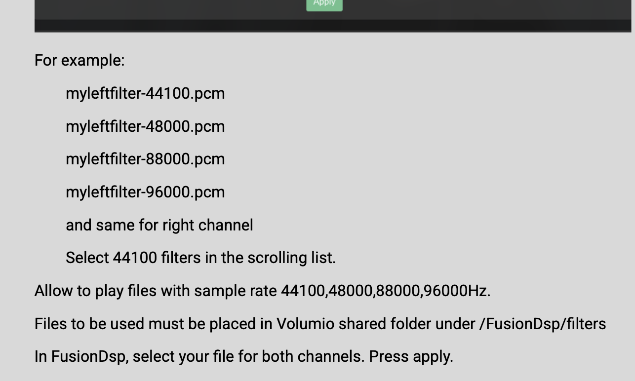

May I suggest aligning the help doc’s info on filter auto-switching with the info in the tool tip within volumio? I first tried the naming scheme in the help doc which did not work (with file names following the help doc verbatim). The tool tip’s naming scheme did work.
Thank you.
If you enable resampling in FusionDsp, you have to choose a filter that matches with the samplrate selected. In that case, there is no switching.
If the samplrate is different, it will work, but the signal will not be corrected as it should and the same for the sound. Do not use!
When effects are enabled/disabled, it doesn’t affect samplrate.
For the online help, I don’t see what is wrong. Files naming for auto switch is ok. Can you elaborate?

Thanks for explaining. I think it would be useful to include both those points in your how-to doc and/or tool tips because it’s not clear based on the plugin GUI: 1) do not use resampling with variable filters, and 2) that effects enable/disable does not effect resampling.
Re file naming: your how-to doc gives incorrect numerical suffixes (at least they didn’t work for me):
Tool tip appears correct:
Thank you! I updated the online help! :wink:
