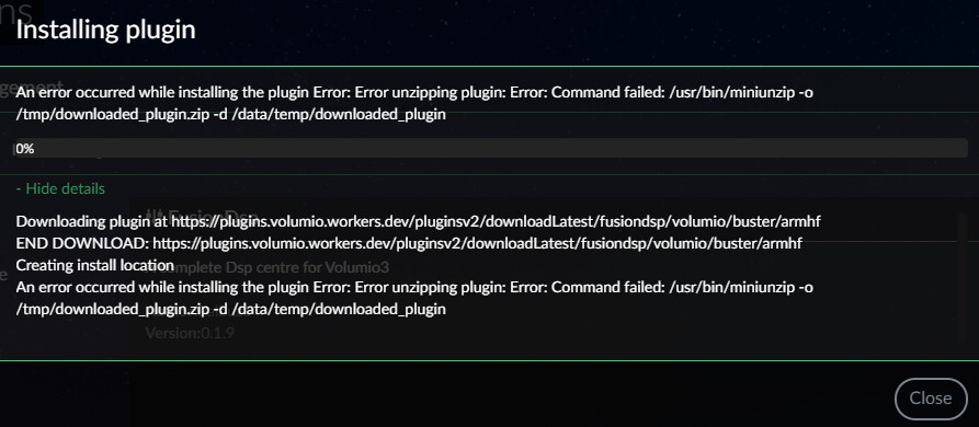

There is something strange going on with the install script. Without reflashing, I removed the FusionDsp plugin and then tried to install 0.1.9 beta. This was the result:
However, I was able to install the plugin manually and it works. The RPi 1 B+ seems to be able to handle at least the 15-band EQ with rougly 50% overall cpu load. I will continue experimenting with convolution filters later.
