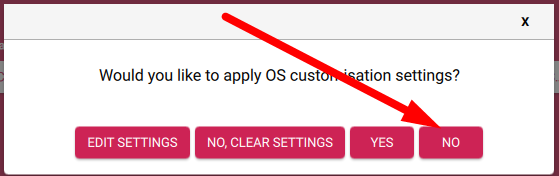

You not allowed to change the password. That’s why your having issues.
Only use the official image downloaded from Volumio.com, unzip it and flash the *.img file.
On this screen:
