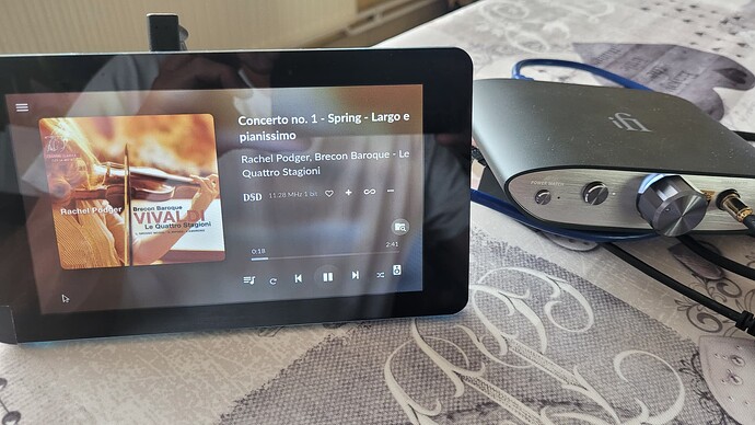

Hi, i’m using version 3.512 volumio on a rpi 4 with screen, USB DAC iFi Zen Dac V2. Updated to latest version.
DAC displays white, wich is NOT DSD256 (it must be red)
DSD256

DSD128 DAC displays blue OK stream is OK
DSD128

Thx guys testversion 3.538 did the trick!
Grtz Ludo
