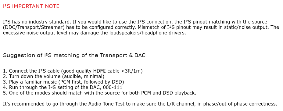

unfortunately the manufacturer of Ares 12th-1 does not explain how the settings are mapped to the I2S pinout on their DAC
they ask the user to perform a trial&error approach, looping on all the available settings for I2S/DSD pinout

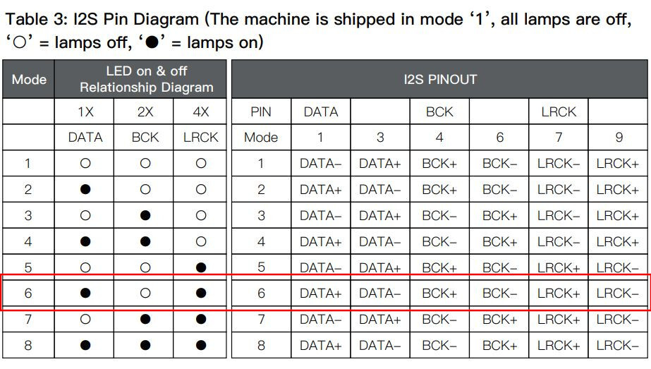

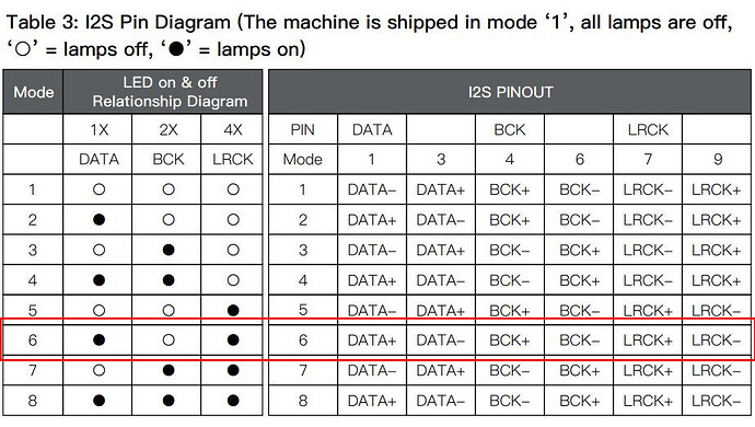

Being the Ares 12th from the same manufacturer as the Pontus 15th (Denafrips), and being the I2S setting method identical (8 combinations, from 000 to 111), my educated guess is that the same setting of Puntus 15th can be applied to the Ares 12th too. Most probably the firmware code-base for the two products has several common parts and the I2S mode selection might be one of these.
My suggestion is to select the mode 6 highlighted in the picture above, and then verify if the left-right mapping is correct for both PCM (I2S) and DSD. You can use the test files provided by Deanafrips.
On the Rivo Plus, please select “Denafrips” in the drop-down menu.

I have Pontus 2. I find the simplest way is to scroll through all the options while playing music and settling on the one that works and sounds best. Note that what works for pcm might not work for dsd.
