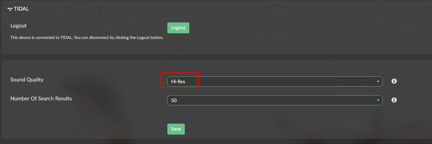

I just recently started see this issue with Volumio all my tracks a stuck at CD quality when playing tidal. I’m on 3.912 and have the Superstar liftetime plan. I have the highest quality set any ideas?
Don’t set Tidal to Highest, set it to:
