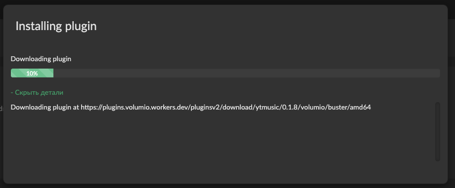

The problem with installing any plugin through the UI .
I found a similar problem in the thread, that’s why I asked.

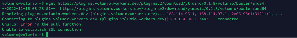

GnuTLS: Error in the pull function.
Unable to establish SSL connection.

the only way to install the plugin , I have
download the archive on the MAC , upload via sftp to the device with Volumio
And there ssh command volumio plugin install
download the archive of the plugin, on the device with Volumio I can not wget gives an error
Problem with the url https://plugins.volumio.workers.dev/xxxxxxxxxxxxxxxxxxxxxxxxx
From another domain, wget works.
